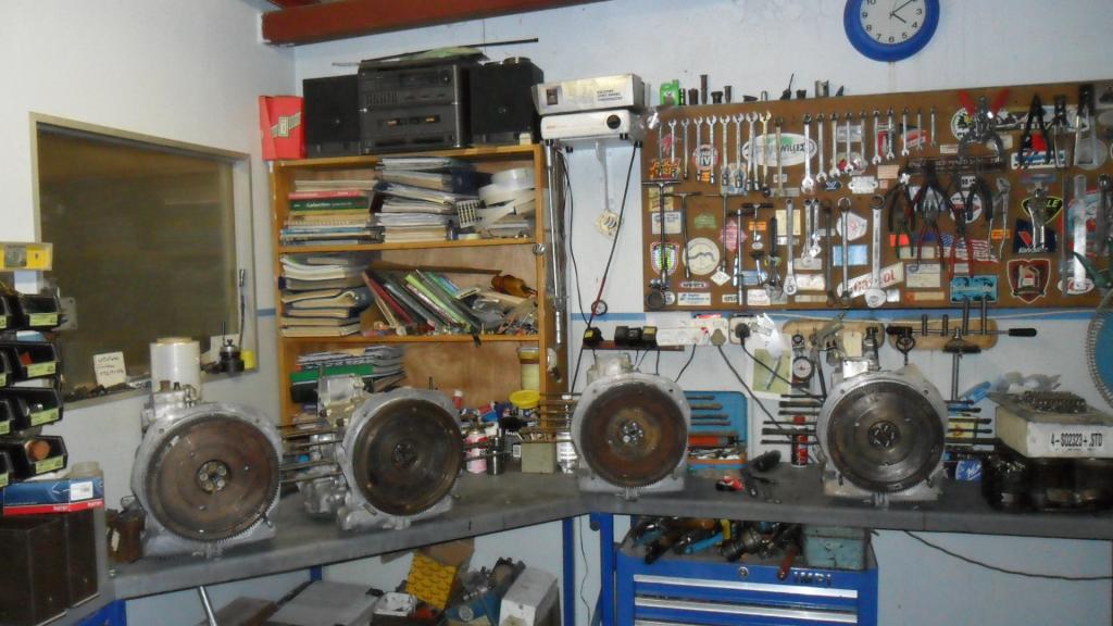

On the bench at the moment is quite a selection of engines all in different configurations and styles:
1 2056cc engine for an autovilla sporting 2.1 wbx FI
specs: 96mm keith black pistons 42x36 valves web cam
2 2056cc engine for a split bus featuring an upright conversion and webers
3 2035cc engine for a bug featuring an upright conversion and aftermarket FI
specs: 95.5mm ks pistons 42x36 valves van der linde cam
4 2337cc engine for a bay featuring wbx FI
102.35 bore custom sleeves,71 stroke, scat c25 cam,42x36 valves
5 2140cc engine for myself still undecided on induction or turbo
101.6bore 66mm stroke 48 x 38 valves (ex skyline) cam to be decided
The first four are in an advanced stage with the first trail assebmbly being done
last one still needs a few bits to complete.
I will start posting pics when the parts are clean and on the respective stands and just to make things interesting there is a stock 1600 in the mix as well.

Hi I have been busy trail assembling and setting endplay as well as porting the heads

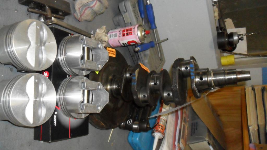

Parts for the 2.3

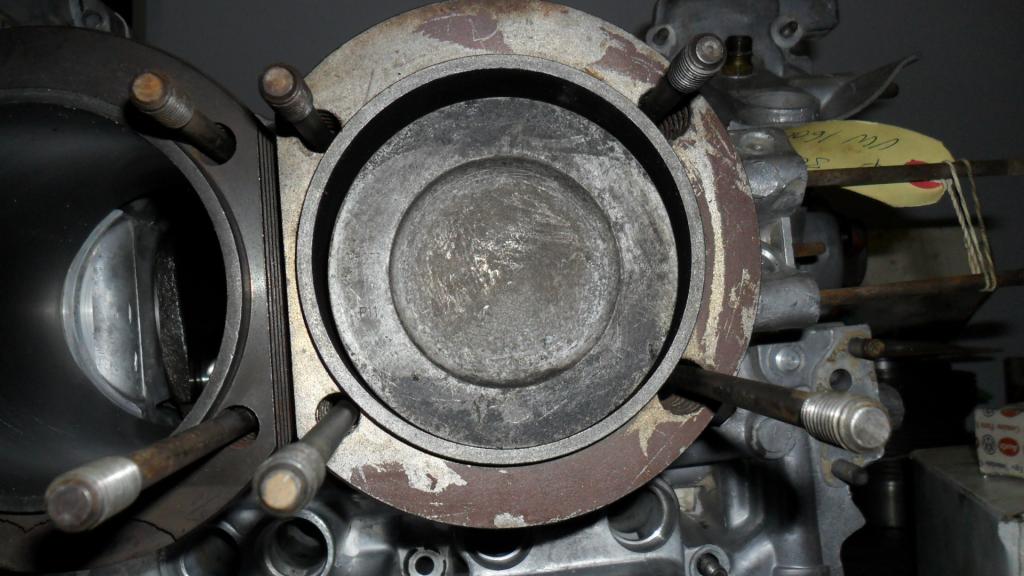

setting a std 2 liter piston in the barrel 94 mm to 101.6mm

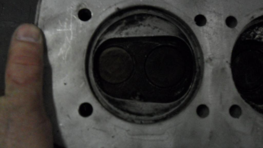

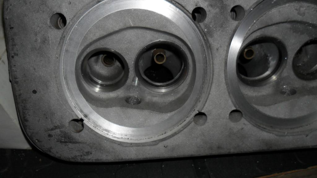

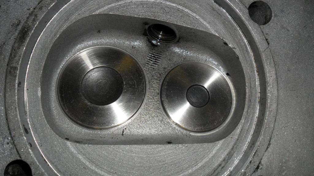

Heads with larger valves

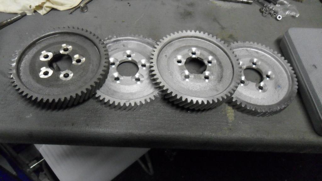

Mods to cam gears for bolting to camshaft

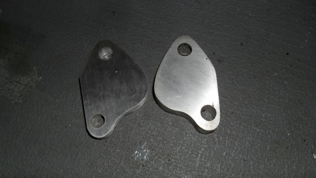

Fuel pump block offs

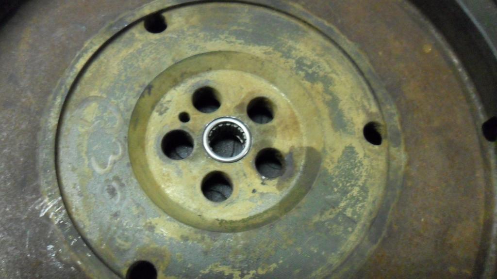

Bearing added to flywheel for beetle box fitment

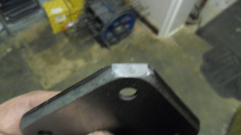

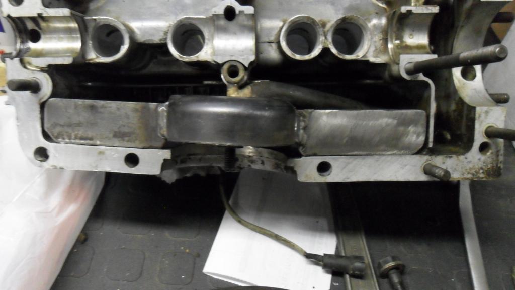

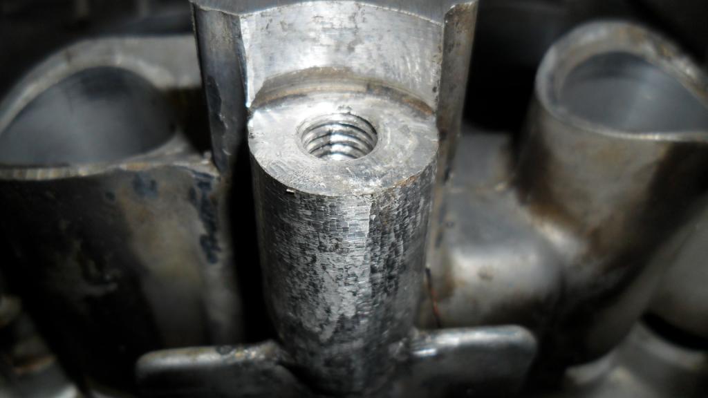

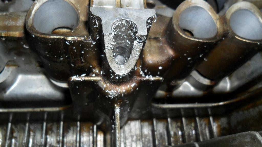

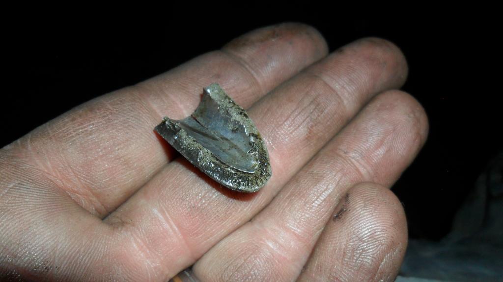

Type four weak spot: tighten the sump plate too much and you break the block. repairs and mods to prevent this as well as control oil surge
Welded an machined
the baffles sit against the bottom of the block thus preventing the damage caused by overtightening
Bigger valves installed
std head
