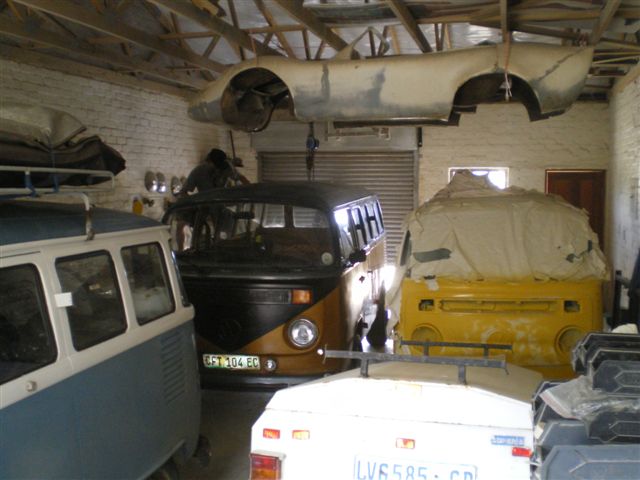

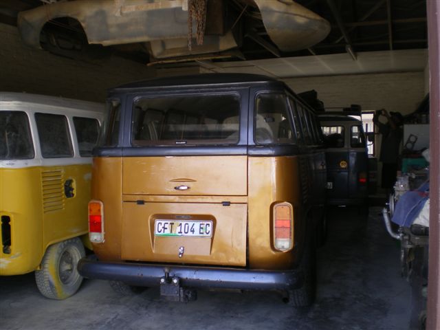

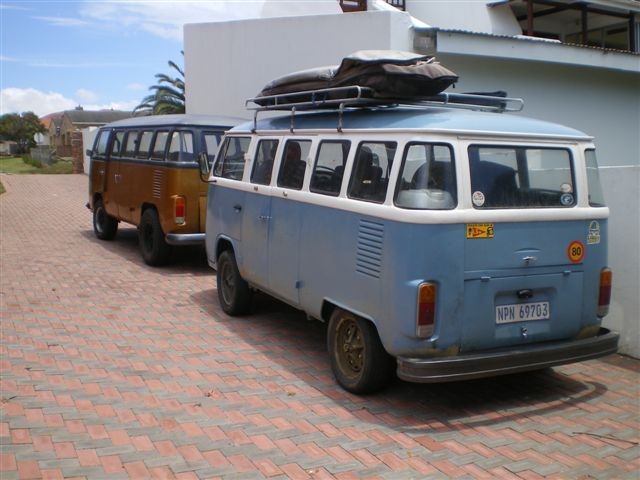

Think today we have made history, not only have we towed an Brazilia with an other Brazilia, by means of A-Frame,
BUT,
we have had 3 Brizilia parked within the same Work Shop, at the same time.
Here be proof for the non- believers....... :roll:
So When and why did this historic thing take place, I hear you all scream with excitement..... :shock:
Well it was when Johan Eagle, and myself went to collect the Cyndi bus for temporary storage, in Johan's Work Shop, till it heads back home by Transporter.
We fitted the A-Frame, and in nostalgic keeping, we slowly paraded them through Jefferys Bay, to the resting place.
In the pics, can be seen Mark and Johan with glass in hand, waiting for me to stop messing about with the camera, and drive "Fugly" to the Work Shop.
