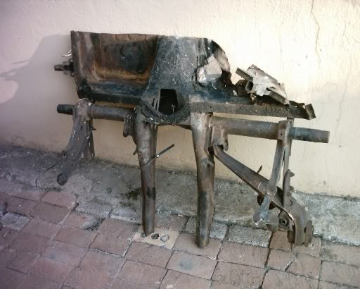

I have done this conversion, and fitted a 944 rear IRS axle, with jigs etc.

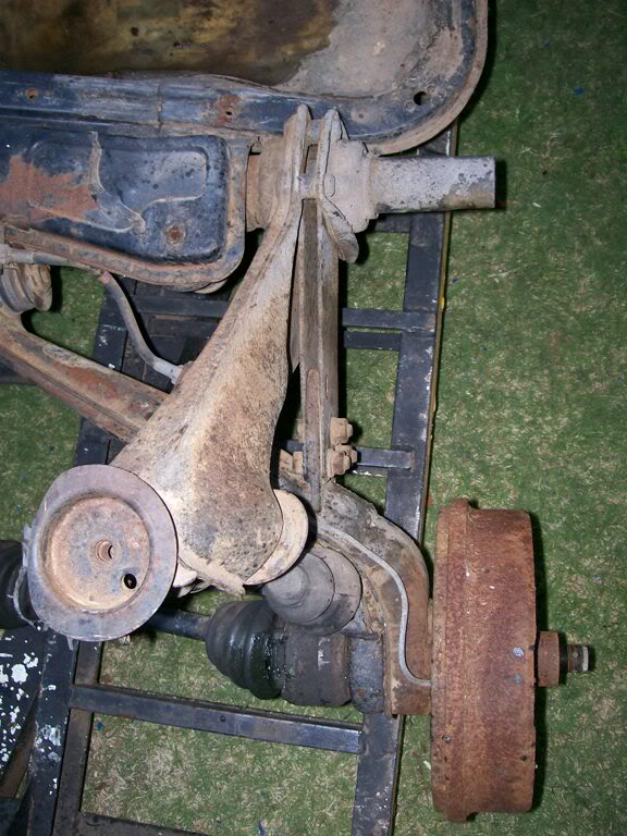

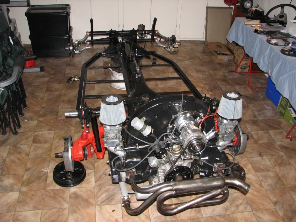

The IRS conversion on my Lolette Buggy was pretty straightforward, it started when I got this old IRS rear clip:
The trailing arms & double spring plate setup were sourced from an auto Type 3 chassis, and the gearbox from a 1303
IMPI then helped me to merge the IRS rear to a king/link pin front chassis
I absolutely LOVE the IRS, it provides a totally different driving experience!

Thank you for the input guys. I have sourced a complete Porsche 944 rear suspension. I have ordered the jig to correctly position the the trailing arm brackets on the torque for welding. I will keep you posted. Will also supply pictures soon. Anyone with a balljoint front beam? the Porsche discs work on if installed on the balljoint suspension.

I am now waiting for my jigs required to correctly position the pivot brackets. I also found an illustrated guide to welding the pivots into place.
