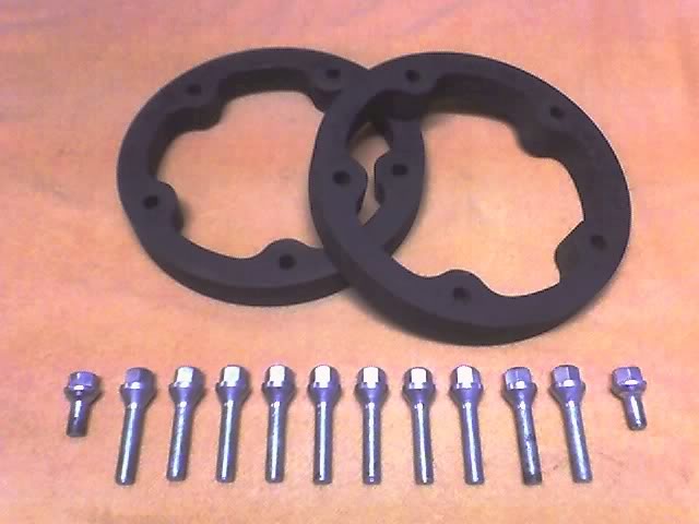

Got some awesome BIG, HEAVY and WIDE spacers from Calooker to widen the rear track of the Buggy, but couldn't find the correct wheel bolts before yesterday, when I got lucky at an obscure wheel shop in Vereeniging.
FYI, some stats:
Puma wheel size (diameter): 14 inch
Puma wheel width: 7 inch
Wheel bolt length required for fitment without spacers (outside 2 in above pic): 41mm
Spacer width: 30mm (yes, they are WIDE - does anyone know the origin of these, they are certainly made with GREAT craftmanship)
Wheel bolt length required for use with abovementioned 30mm spacers, and found in Vereeniging yesterday (inner 10 in abov pic): an INCREDIBLE 76mm!!! (This MUST be some Guiness record :shock: )

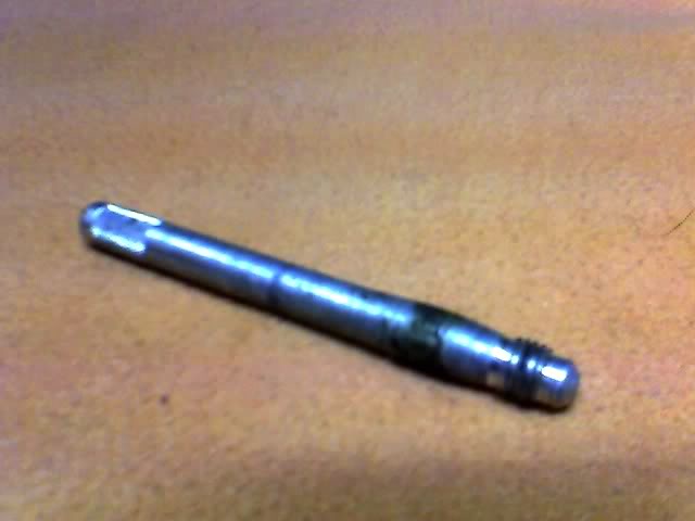

The Fuhrermobile from Stuttgart with the 3-pointed star (a.k.a. boring daily driver :? ) comes standard with this tool pictured below
With the wheel off the car, it simply screws into the wheel hub, and you then 'hang' the wheel on it, so that the holes of the wheel and the hub align, allowing you to enter the wheel bolts easily by hand before torque-ing it. If only I had a tool like that when I tried to help a damsel in distress with a CitiGolf with a flat front wheel at night time a few years ago...
Those #$%'ing water cooled stillborns have the front disk loose from the hub, and you need to align the hub, the disk AND the wheel perfectly before inserting the wheel bolts - ever tried doing that in the dark??? :evil:
