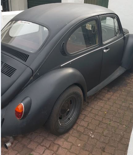

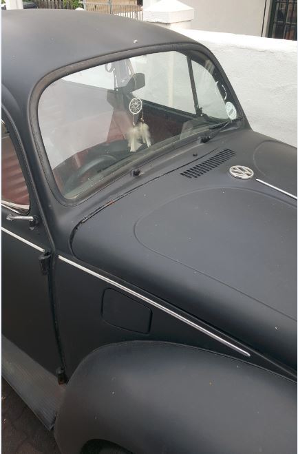

The plan is to keep it as original as possible, but I am liking the look of the matt black on the car, just needs a few more chrome touches here and there. Mechanically, there is popped plug in cylinder number 3
My 72 standard beetle :hangloose:

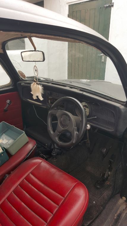

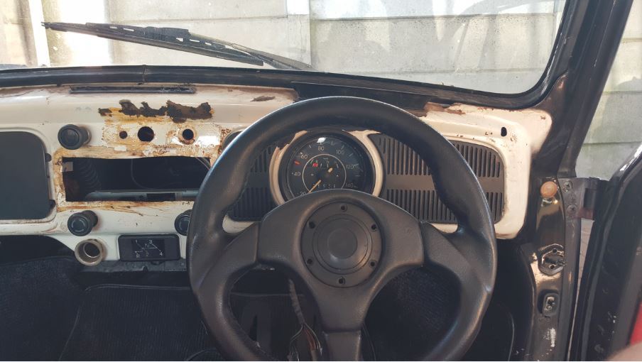

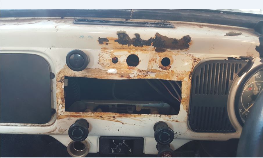

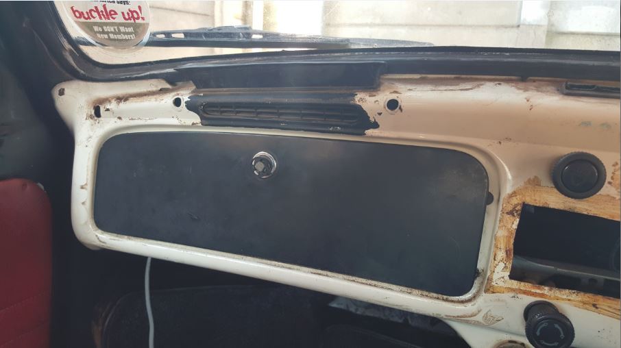

So, over the last weekend, pulled the dash pad off, removed the white sticker off the speedo, fixed the interior light :D and rewired the headlights.
As you can see the speedo is looking a lot better going back to the original, and that steering will eventually be replaced with an original.

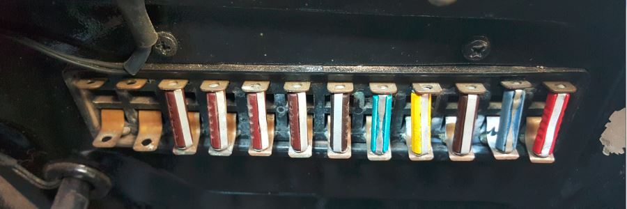

From all the reading up I have been doing, the fuses seem to be either 8Amp (white) or 16 Amp (Red), but I seem to have an array of colours :shock:
can someone perhaps comment on why this done? Is this possibly someone just adding fuses albeit the wrong ones along the way, or are these changes been on purpose through upgrades? The only upgrade I can see on the car though is the electronic fuel pump, everything looks standard.
Re: Rob's 72 Beetle CPT
Hi Rob, and congrats on your first Beetle! I've found that if you ask the same question to 20 different Beetle 'experts', you will most probably get 20 totally different answers, leading to total confusion.
My personal advice would be to first get the car roadworthy and reliable. Get to learn how things work and why they are there. Go on long country drives, but carry basic tools with you. Get to learn the cars limitations. Check for potential fire hazards. Park it in a locked-up garage at night. Get 3rd party insurance for it but most of all - enjoy every moment in (or under) it!

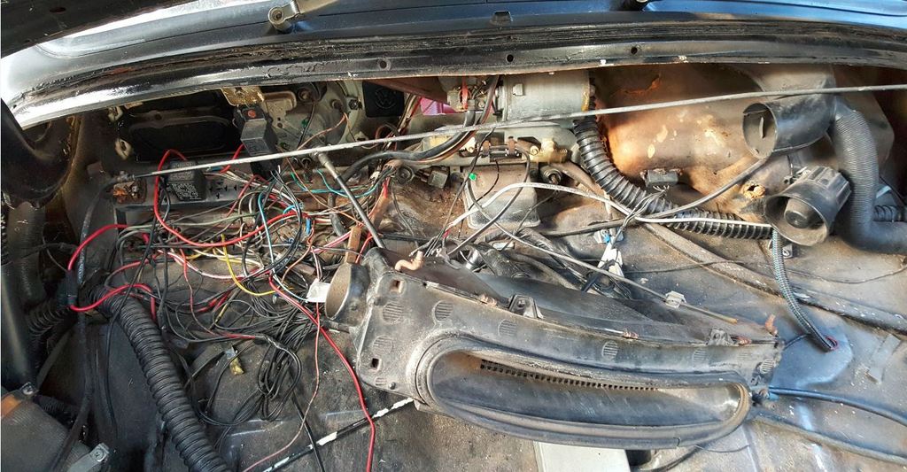

So today was re-earthing the back lights, they had some gremlins would work, then not, then if the lights were on, the brake lights wouldn't work etc... After some TLC, all working again :D NICE.
I was wise to start the wiring at the back, not looking forward to the front :shock:
Nice looking rats nest considering the wiring is supposed to be sooooo simple :D

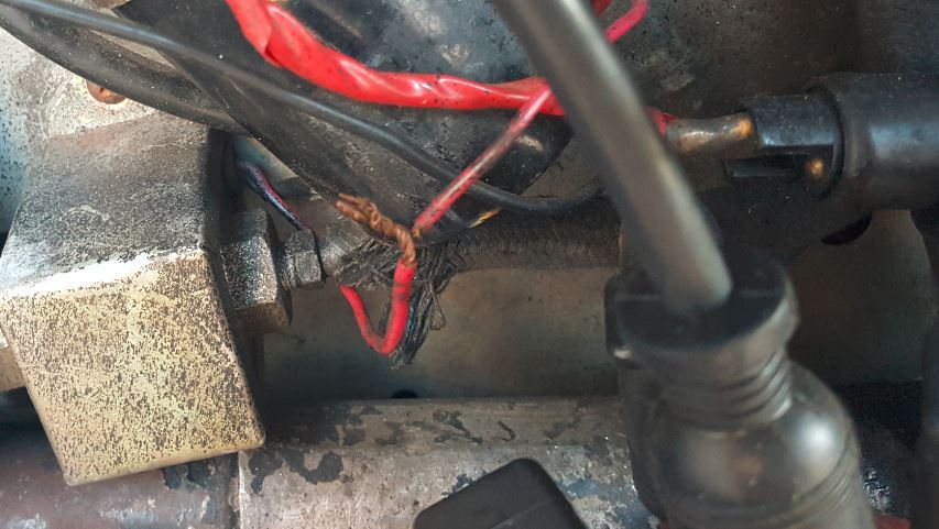

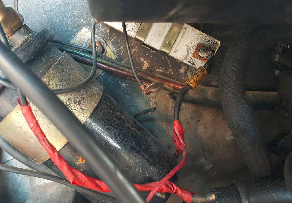

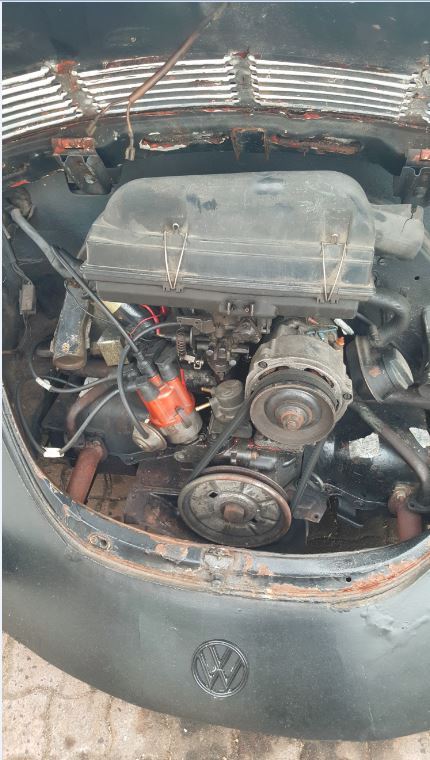

Some dodgy wiring in the engine bay as well, nothing major, just seriously, if you want to do things on the cheap, how much is insulation really?
