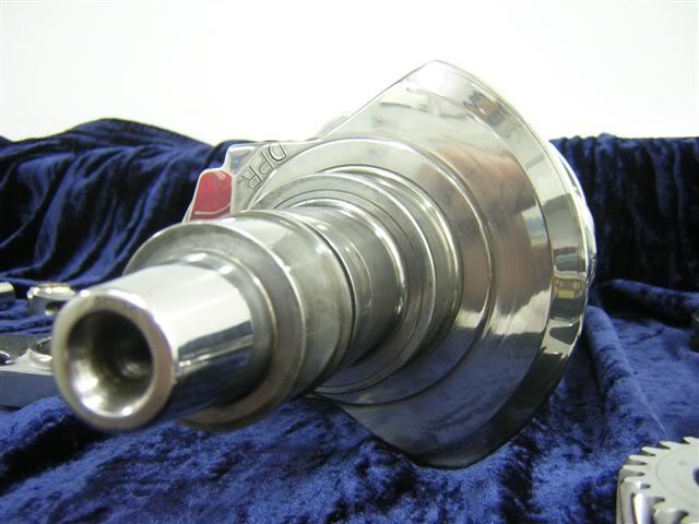

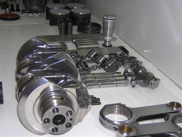

Jake Raby uses a process called Superfinishing-it polishes all the internal parts to a very high luster that reduces friction
Can this be done at home?Do you use some kind of grit to blast the parts with?
Or, do you use autosol and steelwool do get this result?
Must say, it looks real cool...

Dont try this at home... its a realtively new chemical etching process which removes the high points of the bumps, without eating away at the low points.
If you try this at home, you will only weaken your parts and possibly lead to early failures

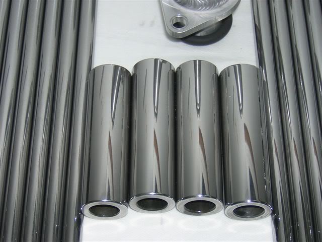

its so smooth to help shed the oil from the parts. Less weight on your parts because the oil isnt clinging to it. Aslo smoother for a lower Friction co-efficient.
