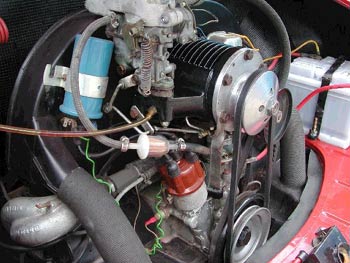

HtF does anyone fit an engine like that into sucha small bay Zero'?

Careful planning and fabrication!? If you draw an imaginary curved line from the Porsche fan to the carb, you will see this charger does actually fit inside the curved line(thanks to the pulley design, were it 'narrows'). So in this case, doesnt seem like a ad design, does it?Merlin wrote:HtF does anyone fit an engine like that into sucha small bay Zero'?
