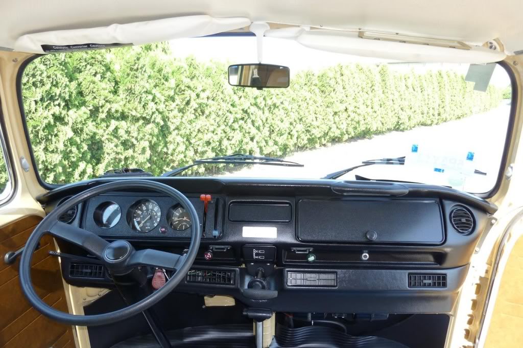

Here is one in my 75 Baywindow. Its condenser is very neatly mounted between the chassis rails in a louvered grid with fans. This overhead unit wont work in a single cab though. I agree with Fig that a aircon isn't necessary in a bus. A single cab is worse than a bus due to the small cab and rear window that the sun bakes on your neck like Dawie said.
You can also purchase a universal air con system complete, its comes with a complete interior unit that can be mounted under dash, but a buses dash is too short so this unit will stick out way to far. This is available at most professional automotive air con work shops.
