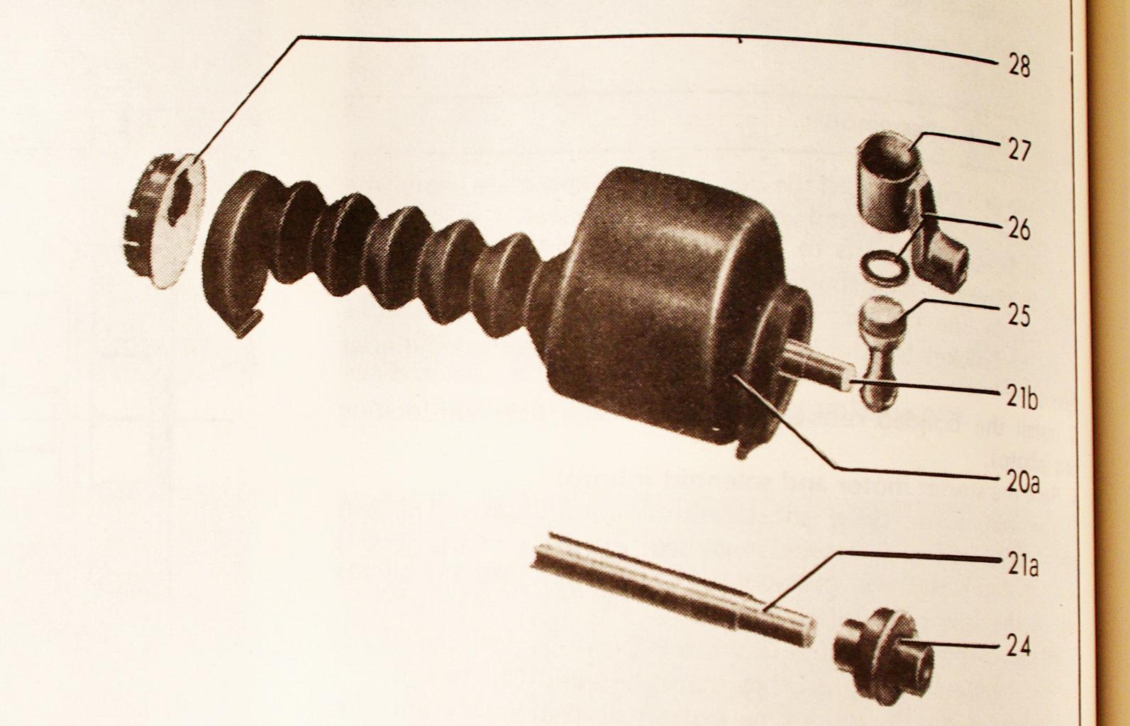

Ok, we have been working on many issues and now that sloppy gearshift is next. I think I found the excessive play area. It is at the back where the gear actuation shaft connects to the gearbox selector stub. Weird connector that can be best described as a knuckle in a socket. See first pic. I am looking at retrofitting the one in the second picture. I might just have to remove the plastic guide close to the joint to allow the two shafts to line up. Any comments guys?ImageImage

Re: Sloppy gear change on Variant 412
Not being an 411 or 412 expert, I would think that there was a reason to fit that type of joint,
As it is nothing like the beetle or the bus, there must be a reason why they would spend more money just to redevelop something that already exists and works very well.
Just looking at the shafts, I would say they do not line up, and therefore the different joint.
Should be able to get parts to fix it, or replace it. I would say that replacing the "O'' ring (26) would fix your problem
here is a full "How To" link ..
https://www.thesamba.com/vw//forum/view ... ?p=7576495

Geesh where do you guys get all this info... this is exactly how it looks like. My car was an auto at some point and I was suspecting that this was a make a plan solution. To test the solution I taped up the ball joint (the part with the oring) to reduce the clearance between it and the tube socket. It made a big difference but ofcourse the tape wont last. Ill figure out how to remove the oring. Thanks!

Those square-head bolts... make sure one of them is'nt loose. Their lock-wires are missing.
Don't modify or fit the more solid joint from a beetle or kombi. You might then break the transmission's nosecone.
Drivetrain's weight is taken mostly by mountings above engine/gearbox parting line. Rubbers at nosecone are not mountings, just bump-stops. There is supposed to be lots of movement, especially up/down. That linkage was specially designed to take care of that. Mostly the problem is elsewhere.
If mountings are bad, or drivetrain mis-aligned, this will affect shifting.
By the way, some pictures in the service manual only apply to very early 411 cars and are irrelevant to later ones. Those early cars had no top gearbox mountings but strong nosecone mounting instead. (Like an early baywindow).
If the issues are sorted, the 412 shifts better than a beetle.

Thanks Dawie. I can see what you are saying here. Any idea where I can source the male part of the joint? The top part where the oring sits is quite worn and is def where my play sits.
