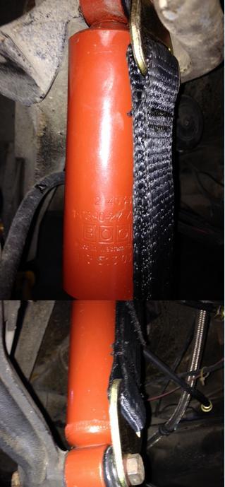

Re: Camber Compensator Suppliers
The old Toppies used to strap the back axle when racing with canvas straps,
(was a bit of a wind-gat when young, did it to my Fastback way back then) :oops:
this makes the bounce up rather sudden but not as if it was end of shock.
Sure you will be able to get powerful bungy cord or strap and have the cable guys fit an eyelet to the end to fit into the shock mount.
(eyelet then down around side shaft and back up with a 2nd eyelet.)
I would put it between mount and shock to prevent too much tension on bolts.
This would give you more stability then the camber straps, and stop the car rolling over.
OMO

Herman those are just suspension limiting straps mostly used on track racing

Boet Bugger,..does you "blade" also pivot from the bottom of g-box ?
Herman,...now that you mention the strap,........my late dad was a keen fisherman,.......in the good old days when you could go down the beach for kilometers,....to get to the "pits" for the BIg fish,....stayed overnight and all that goes with it.
To the point .....he made some strap from shockpost to keep the backend from chucking everything out the buggy when. 'Unseen, dunes are crossed!
I did some flattrack running,......on salt......absolutely without his knowledge!,....let alone permission!.....those straps did the trick !
Haans wrote: Sat May 02, 2020 12:19 pm ........those straps did the trick !
Regards Haans
You right, All the years that I want to see Beetle compete, never saw one roll with straps on.
Yes these other fangled systems where available, but all used straps.
