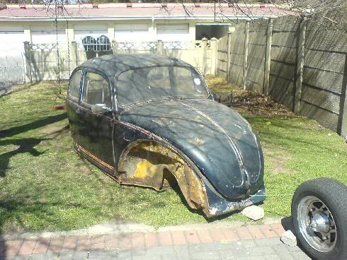

Seems the projects are getting more and more. Well here's mine:
What I've got to start with. (I hope these images will display allraait)

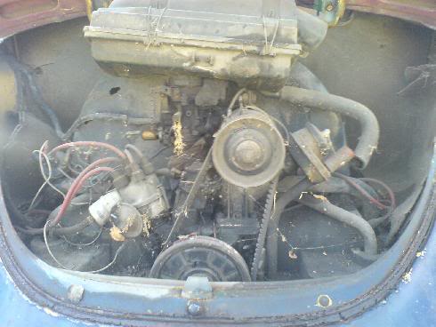

Ol' Faithfull. This motor will be replaced - hopefully - with a type 4, if I can source one. Otherwise a rebuilt 2L although I'm a bit worried about using a standard 1600cc and upsizing it to 2L.

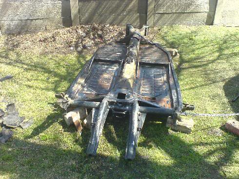

Stripped in 4 days. Awaiting V.Spares to collect and cut floorpan to size.

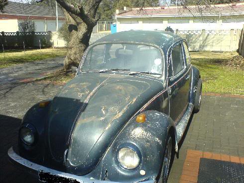

Anyone want a body for free? - need to get rid of it.

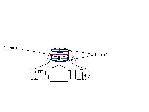

By the way - has anyone ever tried to replace the belt driven air fan with an electric one? If so I'd like to hear from you.

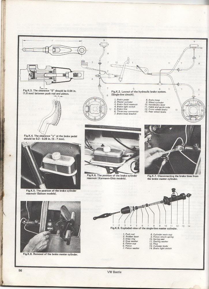

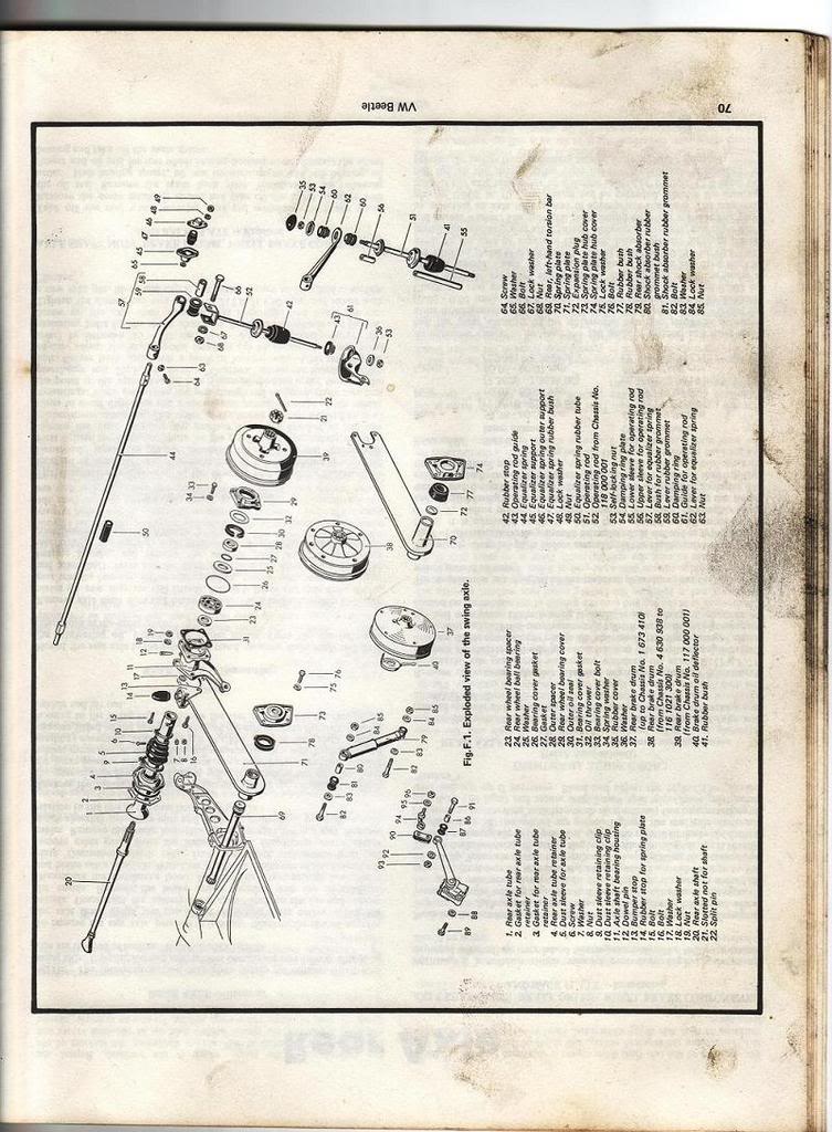

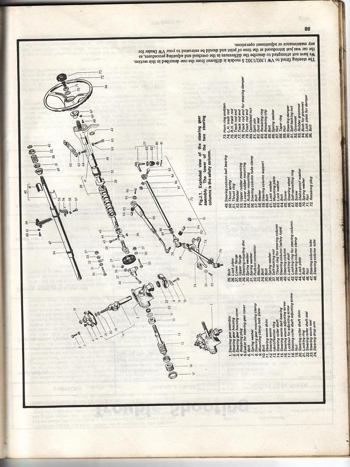

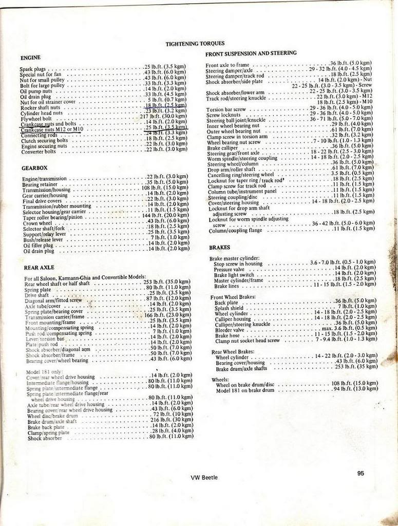

Detailed information is hard to come by. I know - I've searched a lot on the internet. I'll share what I've got since some of these pages are relevant to what I'm busy doing at the moment and it might be of interest to members.
As far as I know these are from a 1968 owners manual.

Yoy will need an electric fan worth about 6 hp to cool the engine as that is what a belt driven fan eats
it will also need to turn at least 3000 rpm
It has been tried but didnt work some drag racers use electric fans just to have some airflow preventing local hot spots.

6 hp is doesn't sound a lot, but I'm going to need to get every hp available to the tyres to reach my goal. I've drawn a pic of what I'm thinking of doing. The oil cooler would have to be an after-market and not so big as to restrict air flow completely. The plan with the double fans is to increase air velocity and volume and the shroud will be fabricated.
What do you think - any hope in the warm place?

Unless yuo have unlimited funds I suggest losing the electric fan idea Rather use a larger turbo!!!!!!

Thanks for the reply. The whole electric fan concept came about because so far I've only been able to source a type 4 sub-assembly. No plates/fans etc.
If I could get a hold of a complete motor, the electric fan idea is out the window. For 2 months now I've contacted scrapyards/enjin suppliers and even pulled some strings in the black market all to no avail.
I know it's not a brilliant idea - it's a desperate idea.
