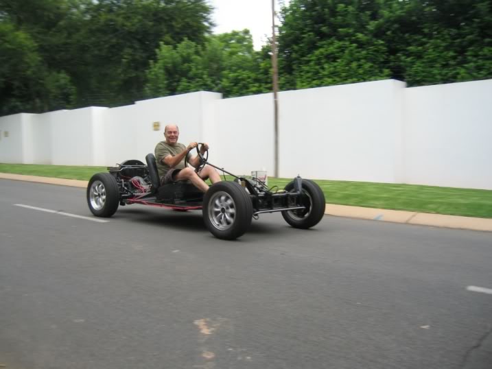

Please can one of you boffs help. I am rebuilding a 62 KG - have been for the past year. Its a bitza with 1302 front and rear end bolted onto the pan. The engine is an ex-industrial Porsche 1680cc unit but with the correct 912 carbs/flywheel and other bits. When the pan was complete and rolling with the engine mounted I drove it around and it was fine - and I was able to sort out the engine and suspension. I then mounted the body after quite a bit of cutting, and most recently raised the rear torsion bars as the back end was sagging a bit.

Updates on bastard KG project
Yup - have progressed a bit since the last pic. Now body on, full interior re-do -sorted in most areas, but still the persistant engine wont turn when you hit the starter, as described above. Havent really checked it out as but fixing the daughters KG which had a loose fan and leaking oil cooler, but thats done so intend to get back to the project car.
Will post an updated pic soon.
Hi Webster,
Your problem sounds almost impossible. Only thing I can suggest is ---Do you have compression on the engine when you turn it over by hand?
When u use a 6v starter on a 12v system it swings the engine very fast, but you should still hear the difference between a starter that has not engaged and one that has.
I assume you do not have confirmation that the motor does not turn when you crank the starter, but it just sounds as if the motor is not turning because the starter spins so fast... if that makes any sense.
The Pic brings back memories.. Like the fuel tank and wiring job. LOL
