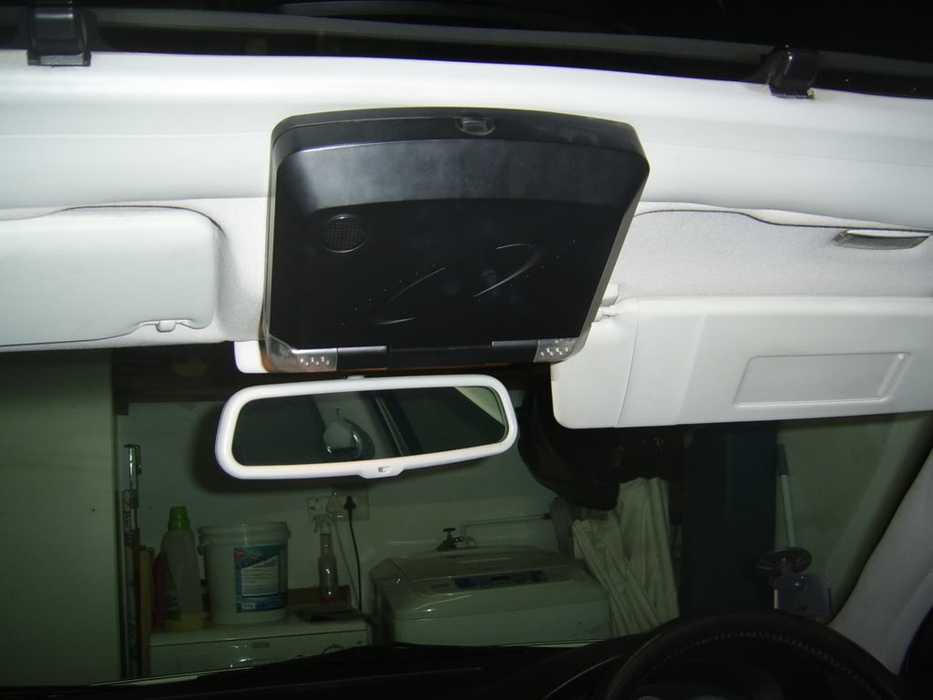

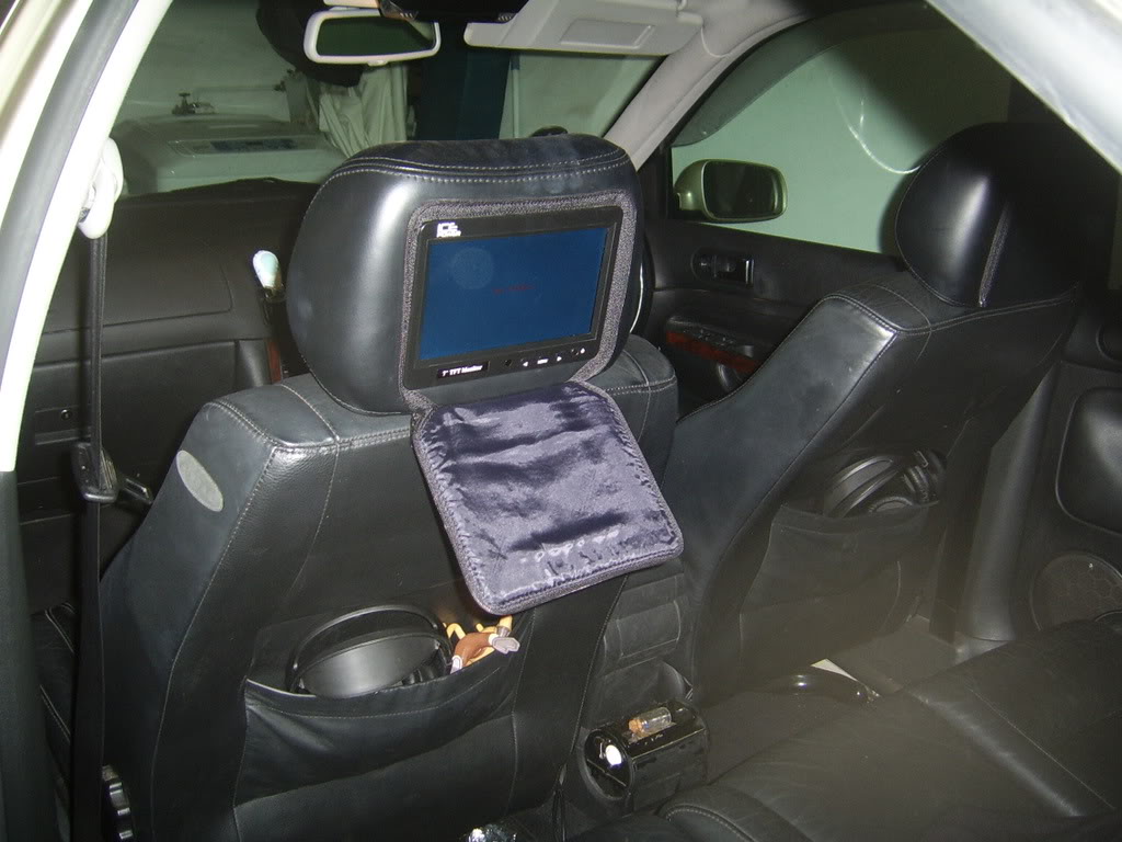

I did a whole install in my Jetta.You have to decide what you want in the car,and where you want it.I installed the PS2 in the rear seat and two screens in the front seat head rests.You can fit the seperate screens,but that will mean buying screens that fit with straps,not always succesfull.The ones I bought you can buy from most of the autoshops like Autostylin.It's neat and has a flap that zips closed when not in use so you can't see it.
The screens I fitted has infrared senders so that you can use wireless headphones.I also installed a roofmount screen infront,so that the front pasanger or seatcover can also watch a movie.

Chris i saw Autost yle sell those hearrest units for like just over R2k for a set, what i s the with of the t steel legs for those headrest and what is the thickness of them? need to see if it will fit on my "mazda" donar seats.

Those legs will fit any seat.It has a an insert that goes into the hole of the seat,and the legs are adjustable to any width.
