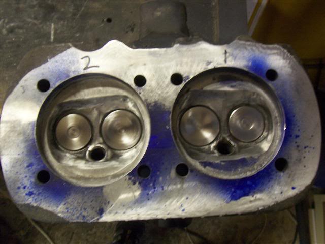

A couple of pics of a job I am busy with, I am hoping to finish the job tomorrow.....
Pics are only of the one head, which isnt complete yet
Heads as I received them
After having the heads cut for higher compression
Full chamber reshaping with old valves in place.
Head also checked for correct volume - 44cc on left, 44.5cc on right - close enough
more to follow as the job progresses

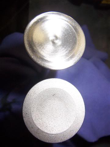

Heads are done and ready to be shipped back to their excited owner...
Decided to do a little swirl polishing.....
before
after
polished the valve heads to reflect a little heat
before and after
final product
The pictures of the ports didnt come out at all and the box is now sealed.
Inlets and exhaust ports were worked for better and straighter flow
Manifolds were also match ported to the heads.
