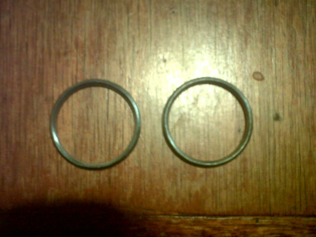

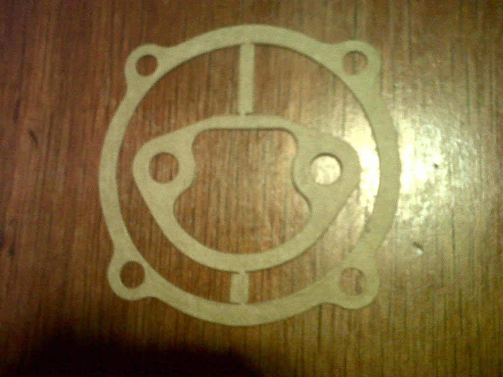

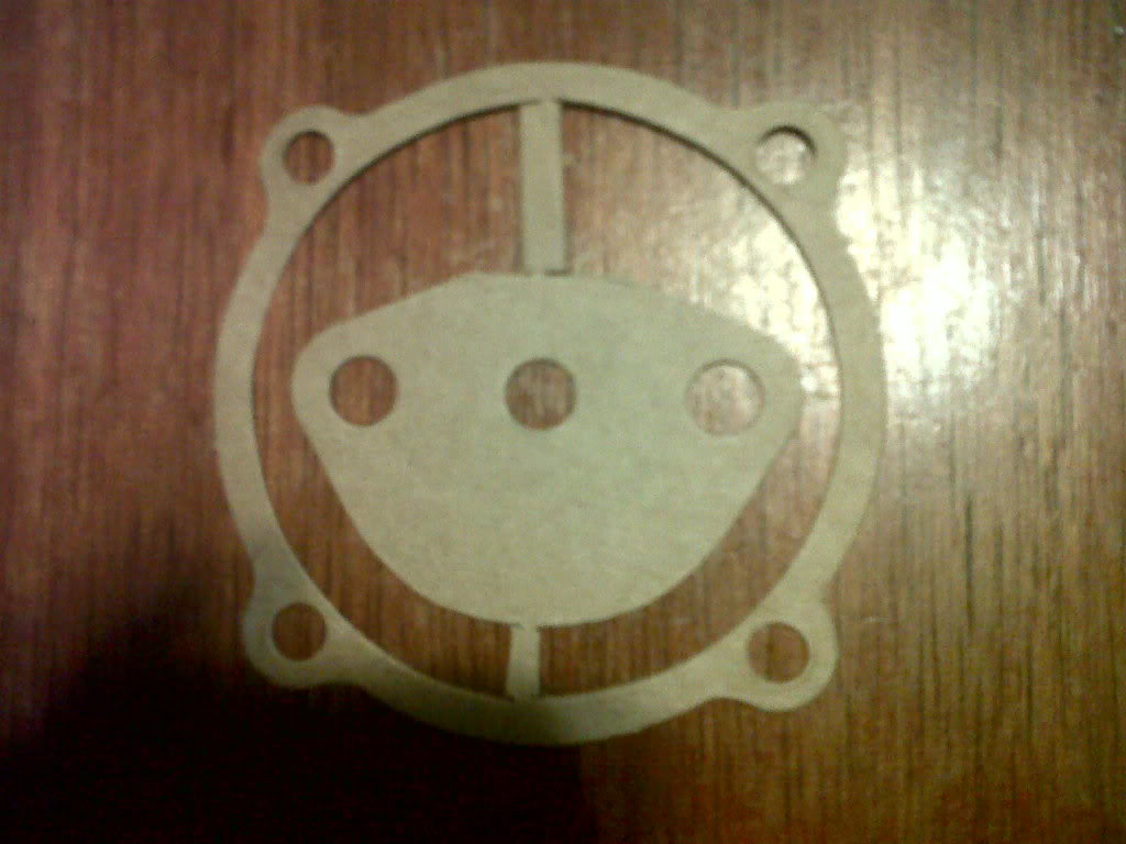

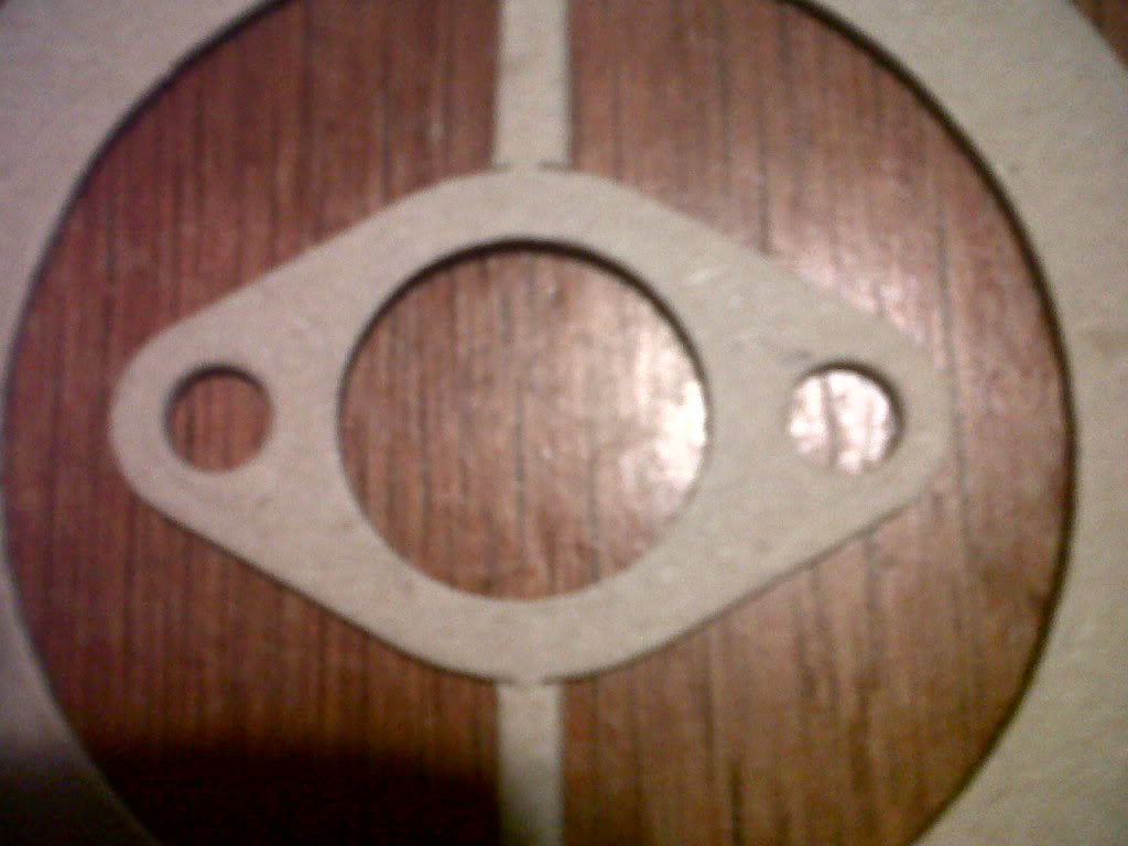

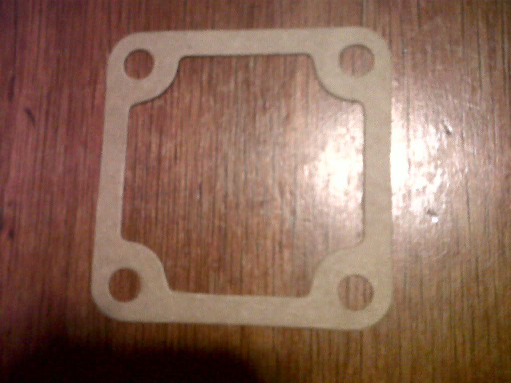

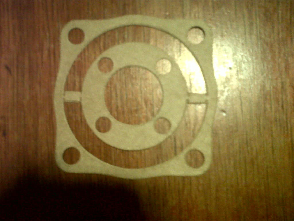

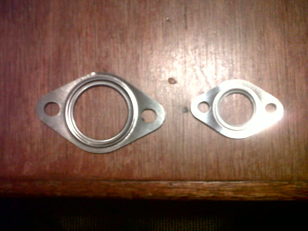

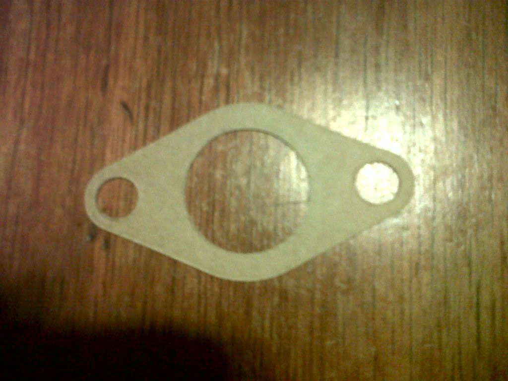

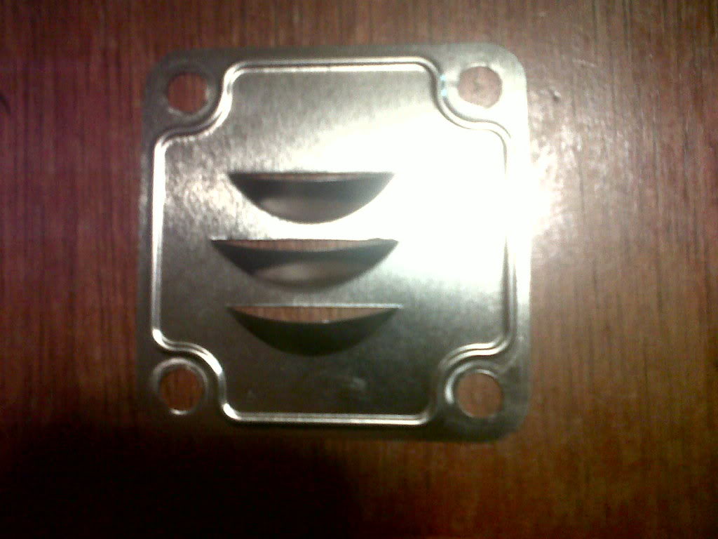

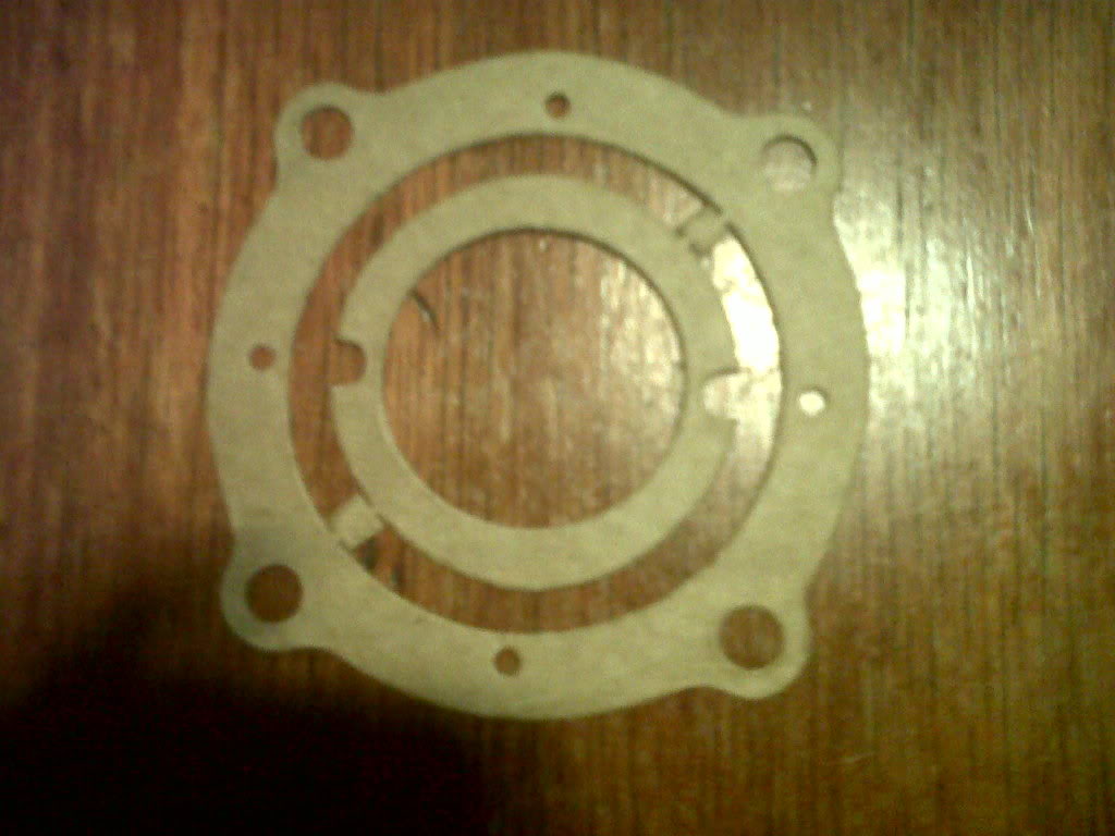

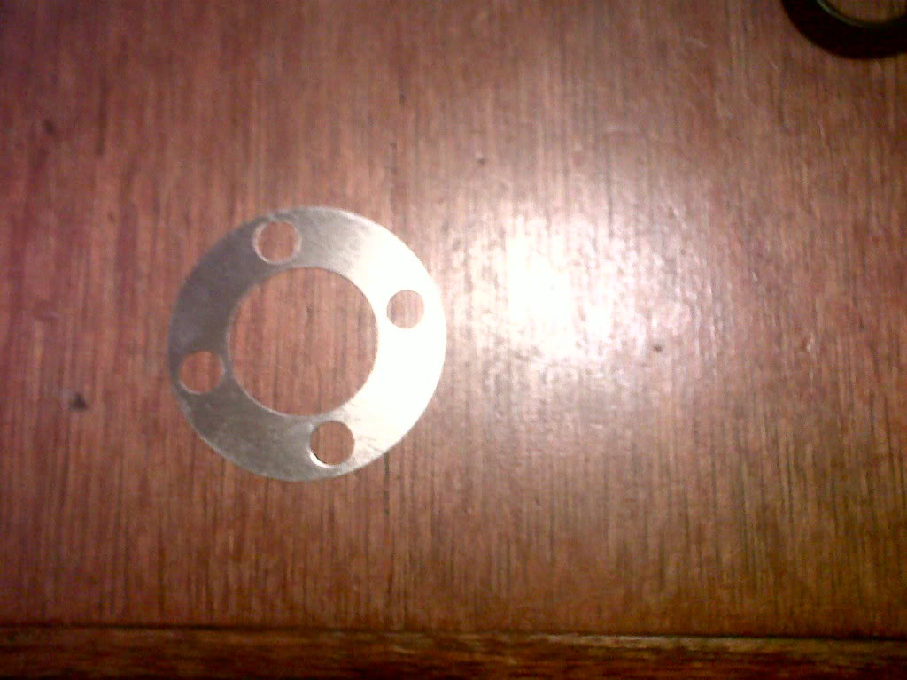

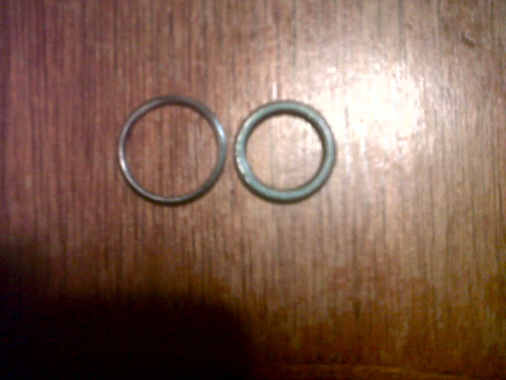

I baught a new gasket kit for the engine and need some help to indentify some of the gaskets...
Photo 1????
Photo 2: Inlet gasket?
Photo 3 ????
Photo 4: It seems to fit on the alternator stand?
Photo 5: isseems to fit on photo 7
Photo 6???
Photo 7: looks like it fits on photo 5
Photo 8 ?????
Photo 9????
Photo 10? it is two differant size of washer type.
Photo 11: the washers is a bit bigger than photo 10...it is the same size as the inlet port? I have a single port engine...and there is no type of gasket for the inlets. only this type of thing.
Photo 12: Exhaust gasket.
Photo 1????
Photo 3 ????
Photo 6???

Re: My 1968 Bug
Please guys correct me if I'm wrong
Photo 2 : The middle thing is the gasket thing for the fuel pump stand, Out side is for the oil pump
Photo 3 : The alternator stand
Photo 4 : I know it fits onto the end of the crank
Photo 5 :Looks like the carb onto stand gasket but not sure
Photo 6: same as photo 4
Photo 7: Not sure ?
Photo 8: is the oil tray thing that goes inbetween the block and the alternator stand
Photo 9: and upwards looks Like some thin to do with the exhaust seals ?
Photo 7: Not sure ?
- Edmond
- Valve
- Posts: 1135
- Has thanked: 22 times
Re: My 1968 Bug
Photo 10 is the sealing rings for the oil sump drain plug and the relief valve plugs, the thinner but bigger one for the relief valve plug and the fatter one for the drain plug
Photo 11 are the intake manifold sealing rings, these go between the head and intake manifolds.
Phot 7 is the steel shim gasket that goes between the crank and flywheel, it is only used on engines with a non O ring flywheels mainly the 1200 and earlier engines

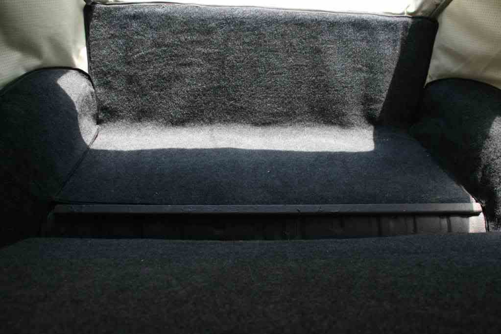

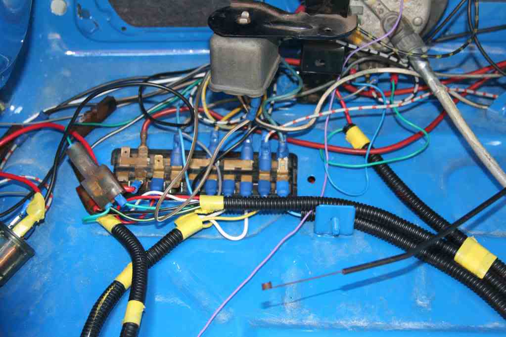

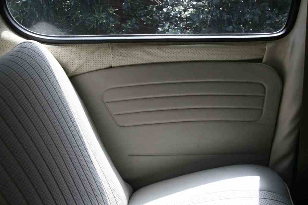

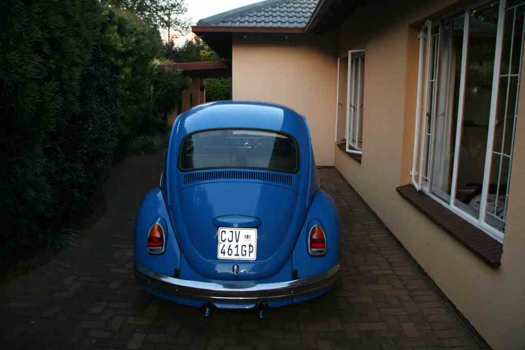

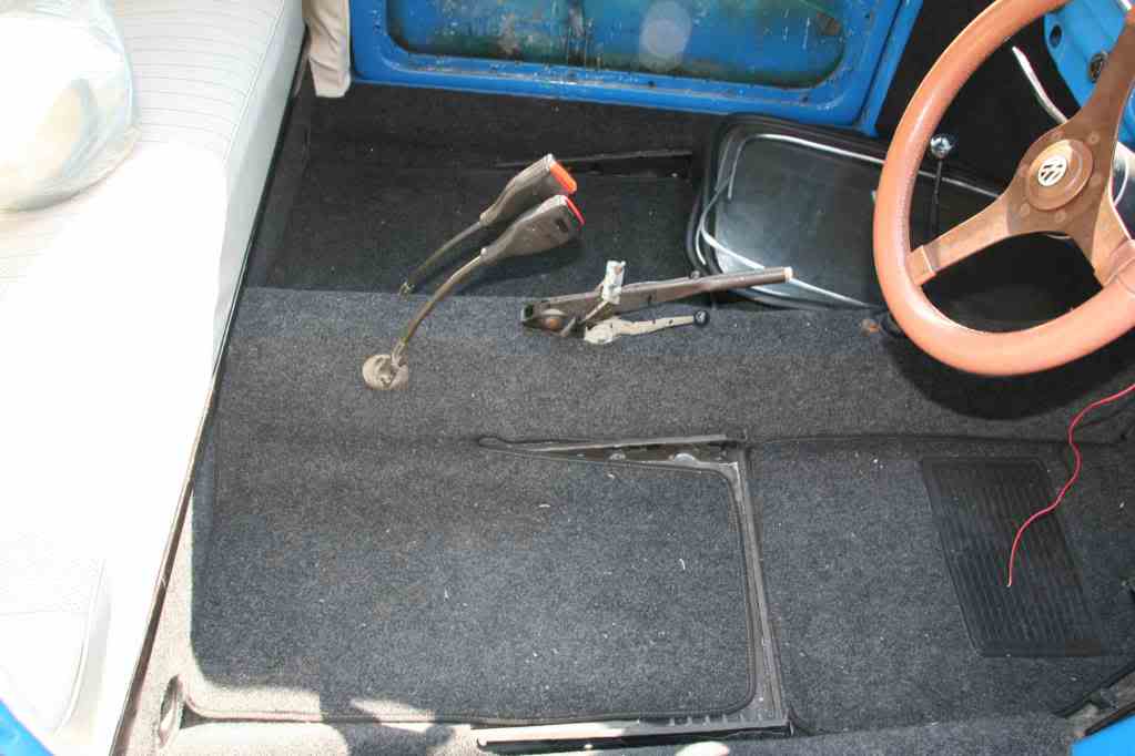

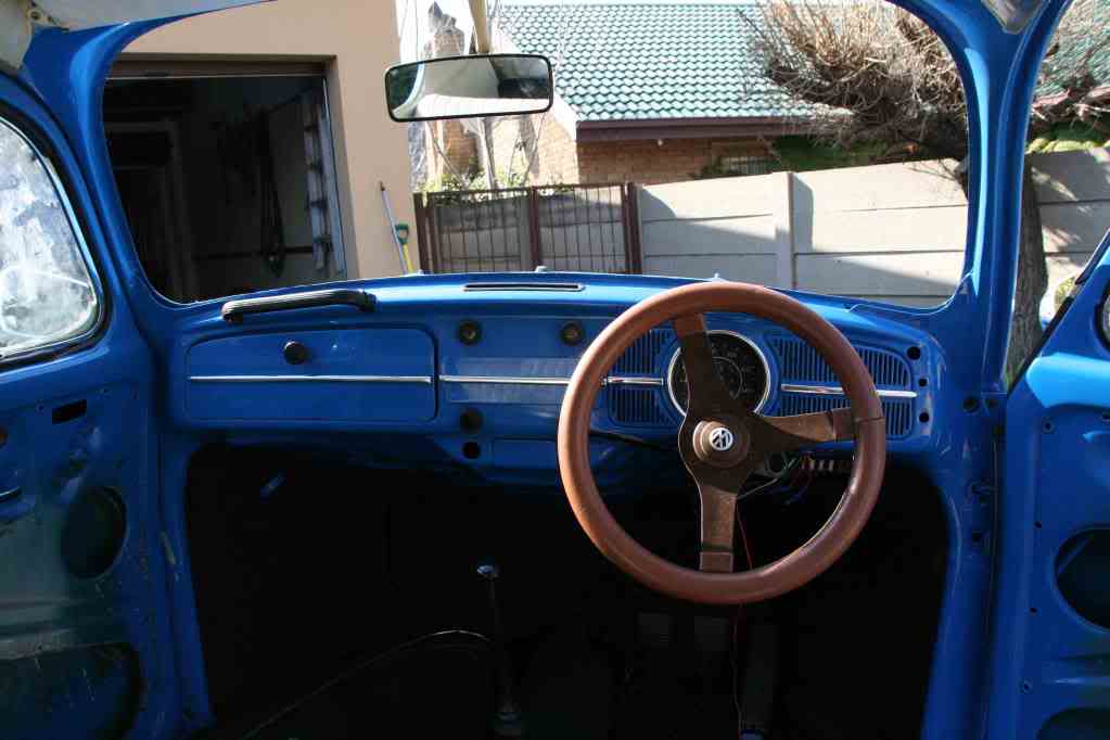

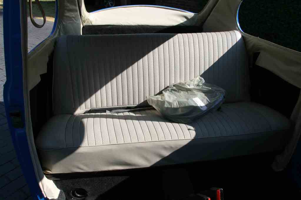

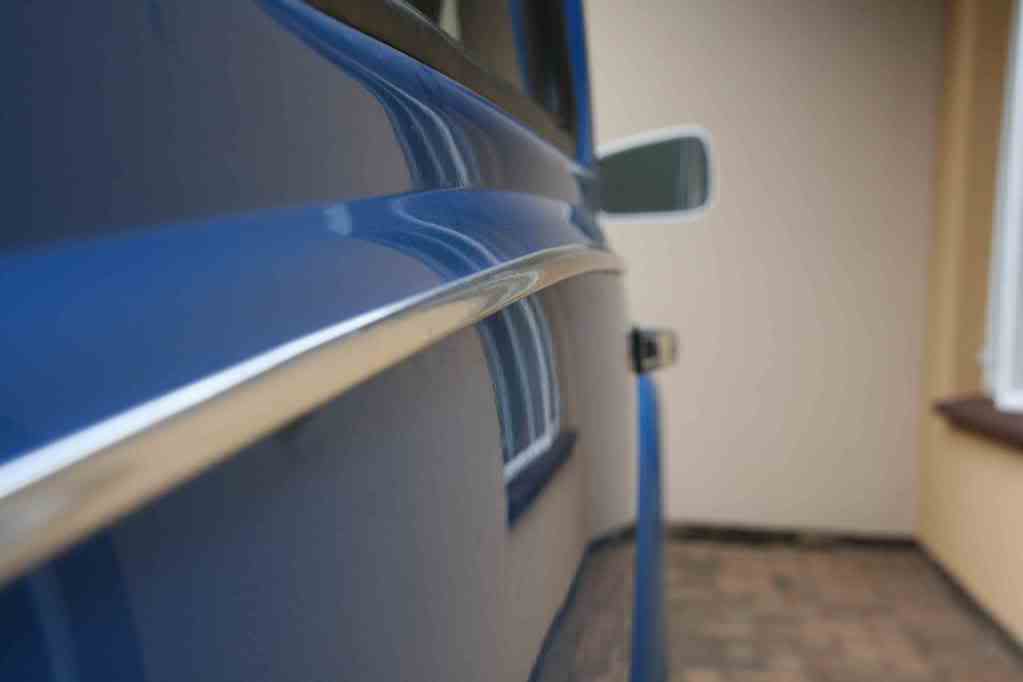

The project is almost finished>>>>
Before the windows was installed>>>

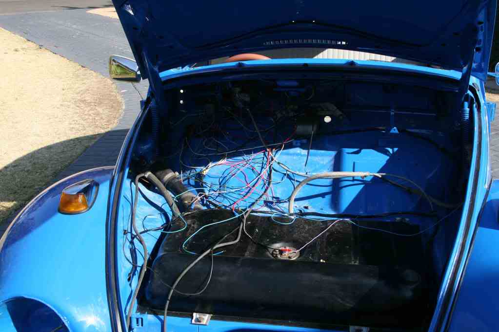

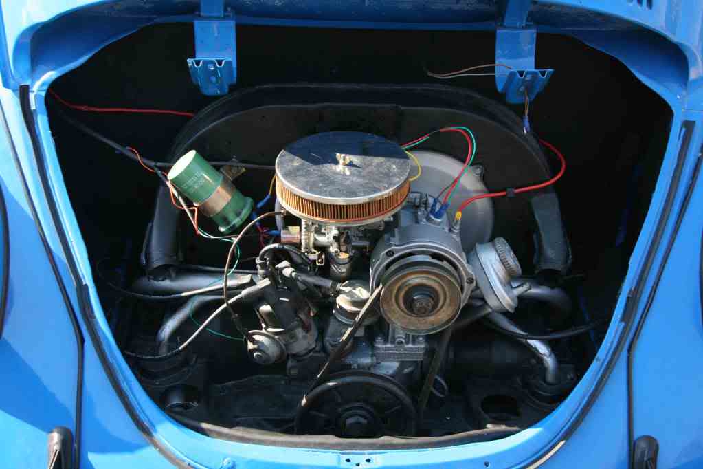

When the wiring wasn't nearly finished

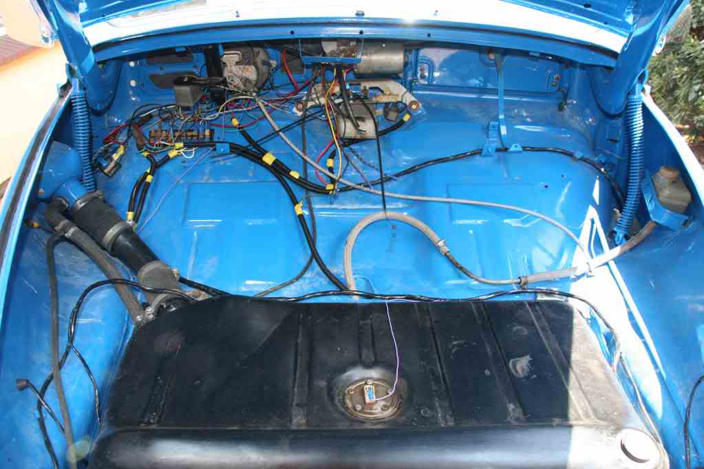

The wiring is finished>>>>

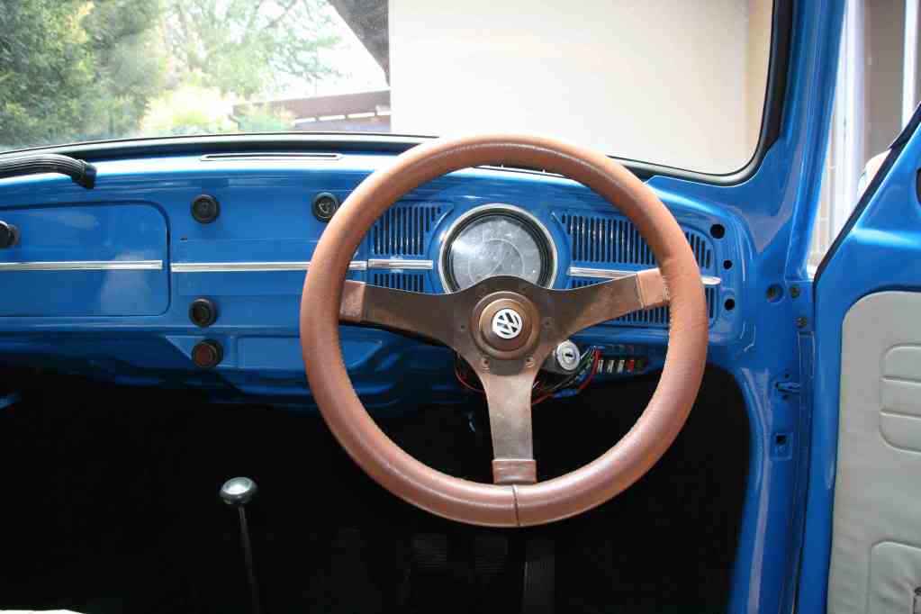

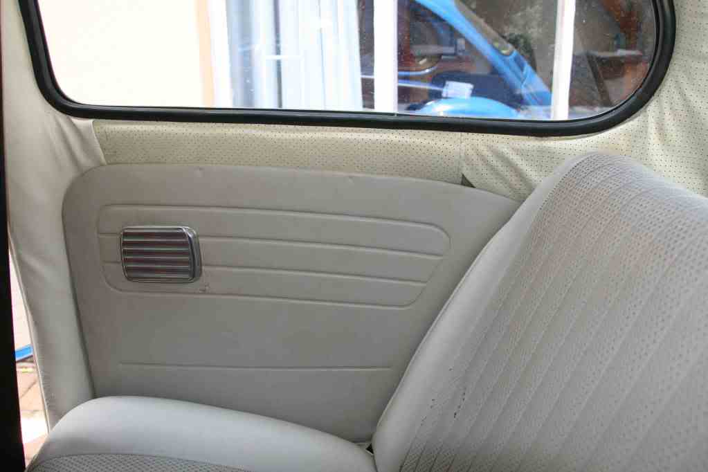

Pictures of the interior

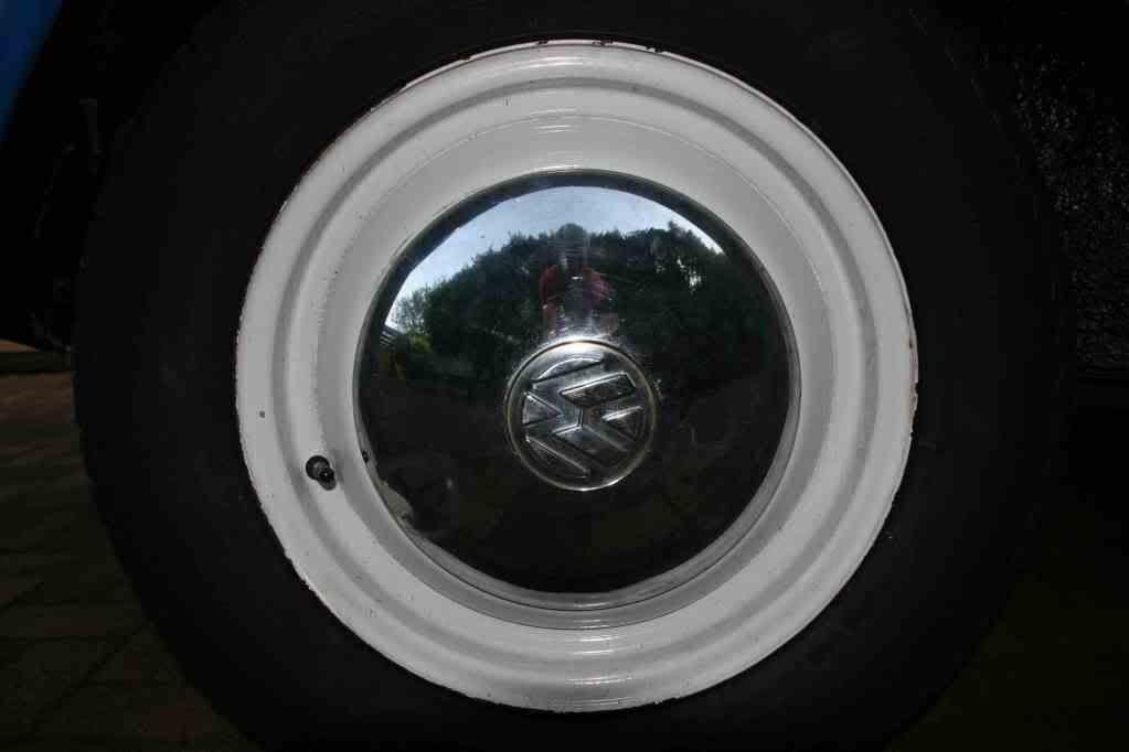

My wheels:

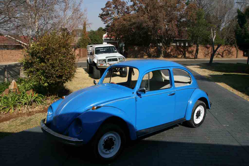

The exterior:
My wheels:
The exterior:
