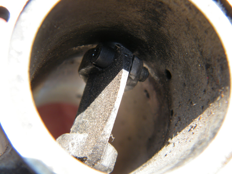

No needles, nor jets
Operation relies on the swinging arm, which is attached to the hollow throttle spindle. The arm runs up and down a tapered groove and this is basically how the mixture is varied. As the fuel is drawn up the arm and fed into the choke area to spray out of crossholes in the spindle. Altering the main running mixture is controlled by a taper screw, just where the fuel goes into the throttle spindle. Moving the throttle on the spindle controlles the part throttle mixture.
There is no choke tube and there are no jets. The restriction caused by the throttle and spindle sucks fuel into the air stream. Fuel trapped in front of the swinging arm gives an accelerator pump effect.
