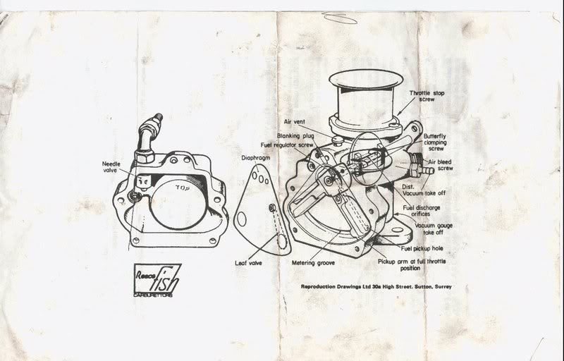

Operation relies on the swinging arm, which is attached to the hollow throttle spindle. The arm runs up and down a tapered groove and this is basically how the mixture is varied. As the fuel is drawn up the arm and fed into the choke area to spray out of crossholes in the spindle. Altering the main running mixture is controlled by a taper screw, just where the fuel goes into the throttle spindle. Moving the throttle on the spindle controlles the part throttle mixture.
There is no choke tube and there are no jets. The restriction caused by the throttle and spindle sucks fuel into the air stream. Fuel trapped in front of the swinging arm gives an accelerator pump effect.
Therefore you tune a Reece Fish carb on your own motor. You need to be skilled at making gradual adjustments. Maybe take your car to a rolling road - tuning these does not take long.
Tuning
Setting the full power mixture:
Undo the grub screw in the float chamber case, so as to allow access to the main jet adjusting screw (Vizard says he has no better word for it). This screw can only be got at and adjusted when the throttle is fully open - which suits the need. Run the engine flat out on the dyno. The Reece-Fish comes with a special adjusting tool. Adjust the mixture screw, until it shows the maximum reading on the dyno.
Setting the part throttle mixture:
Situation: The fuel comes out of the throttle spindle through holes which start off live when the throttle is in the closed position (pointing forwards and backwards - this is in line with the airflow through the carb). When the butterfly is fully open, these holes are at 90 ° to the airflow.
Alter the position of the butterfly on the throttle spindle arm: either let more air or less air in. This will change the mixture as it changes the amount of fuel which happens to be sucked in with the throttle spindle at that particular position.
The pump action is achieved by the swinging arm in the float chamber.

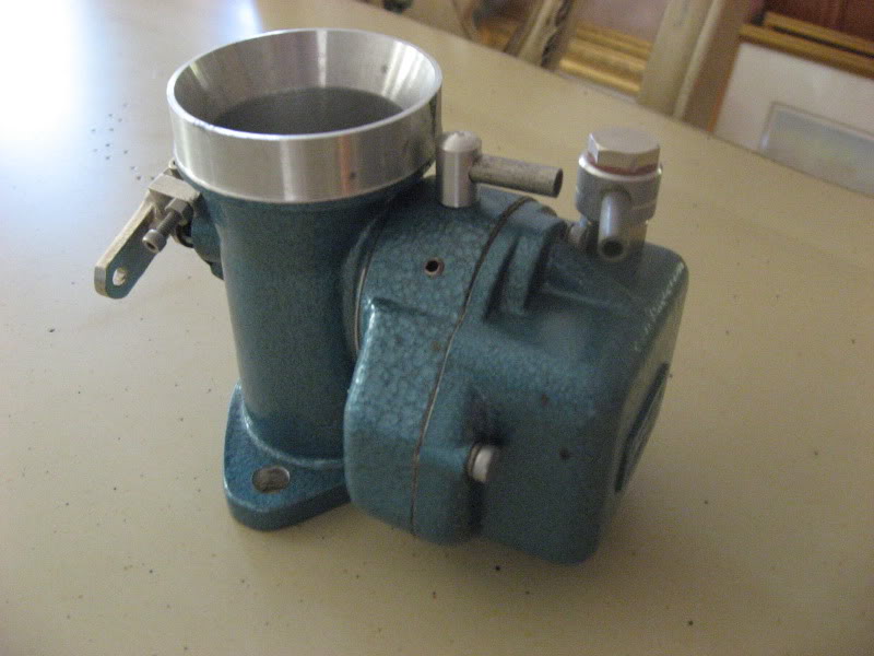

So I've got my hands on a Reece Fish carburetor :)
Its amazing how solid this carb is made.
I hope I can make it work.
