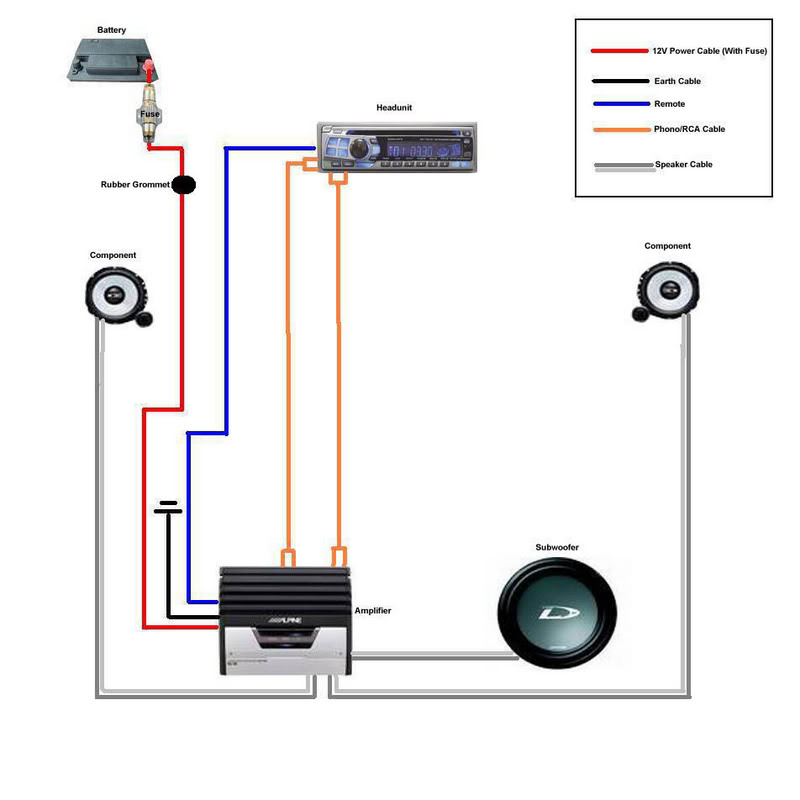

This is a 4 channel amp.
You have only 1 pair of RCA outputs from your radio.
So buy two RCA Y-jacks (that way you plug one y-jack into the right RCA and you end up with 2 rights - it really is just a splitter). Connect these and now you have 4 RCA's (2 left, 2 right)
Connect the lefts and rights to the amplifier inputs
run your 6x9's from channel 1 and 2
run your sub in bridged mode from channel 3 and 4 (usually you connect the pos to 3+ and neg to 4-)
The remote wire from the radio is used to turn on the amplifier
