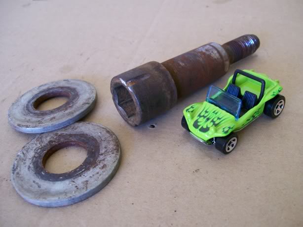

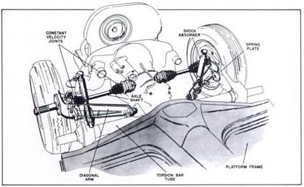

Update 17/12/2008- One MOTHER of a a bolt
Well as said in my 'Wanted' thread, I managed to source one of the IRS pivot bolts (for free, nogal!
) at Volkspares today, thanks once again Jaco and Sarel. Perhaps this technical drawing will put the whole IRS setup in better perspective -

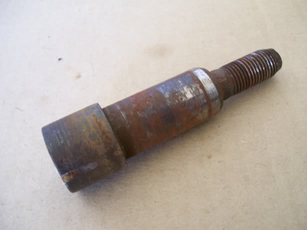

Now the bolt. I have am pretty sure that it is a VW-only component. It is made from high-tensile steel, and has the following dimensions:
Length: 103mm
Diameter (head): 28mm
Diameter (center): 22mm
Diameter (thread): 14mm, the same as a wheel nut of a Bay Bus
Tool size: 17mm hexagonal (Allen key), the same as the drain and filler plug of a Beetle gearbox
Still don't get it? Let's have a look at it, compared to a Hot Wheels Manx, in order to give you a better idea of the size...
The two large flat washers are also a critical part of the setup. Now I need (just) one other bolt. And another two washers
Length: 103mm
