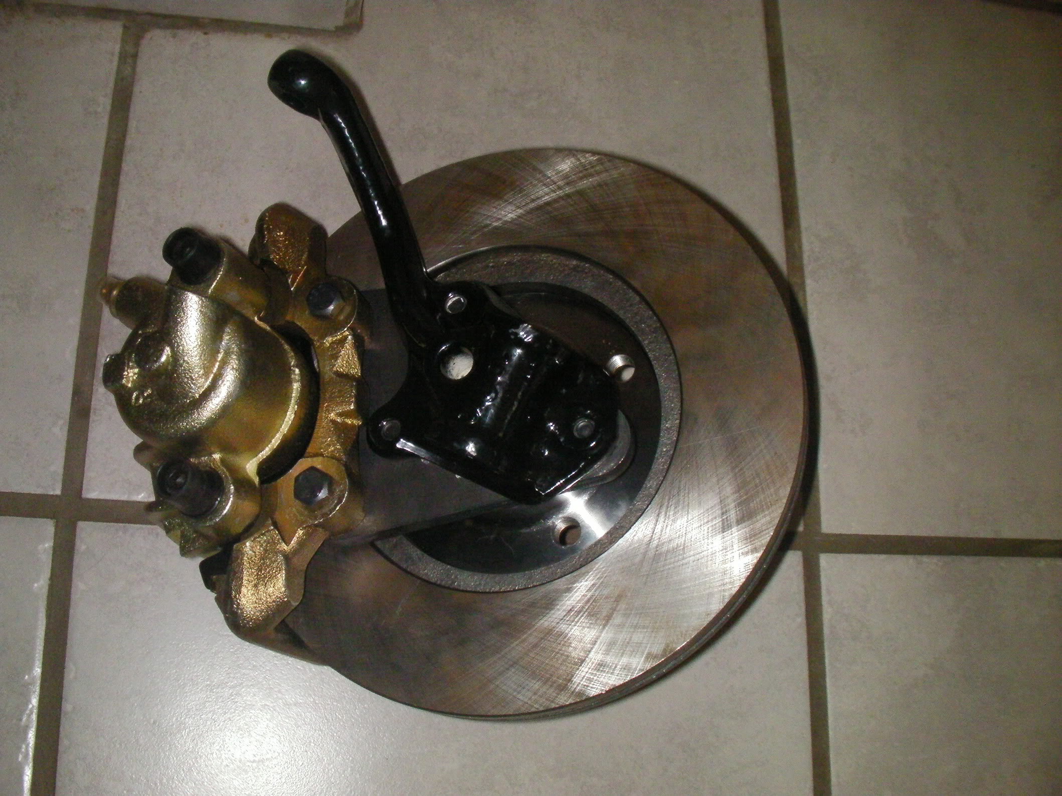

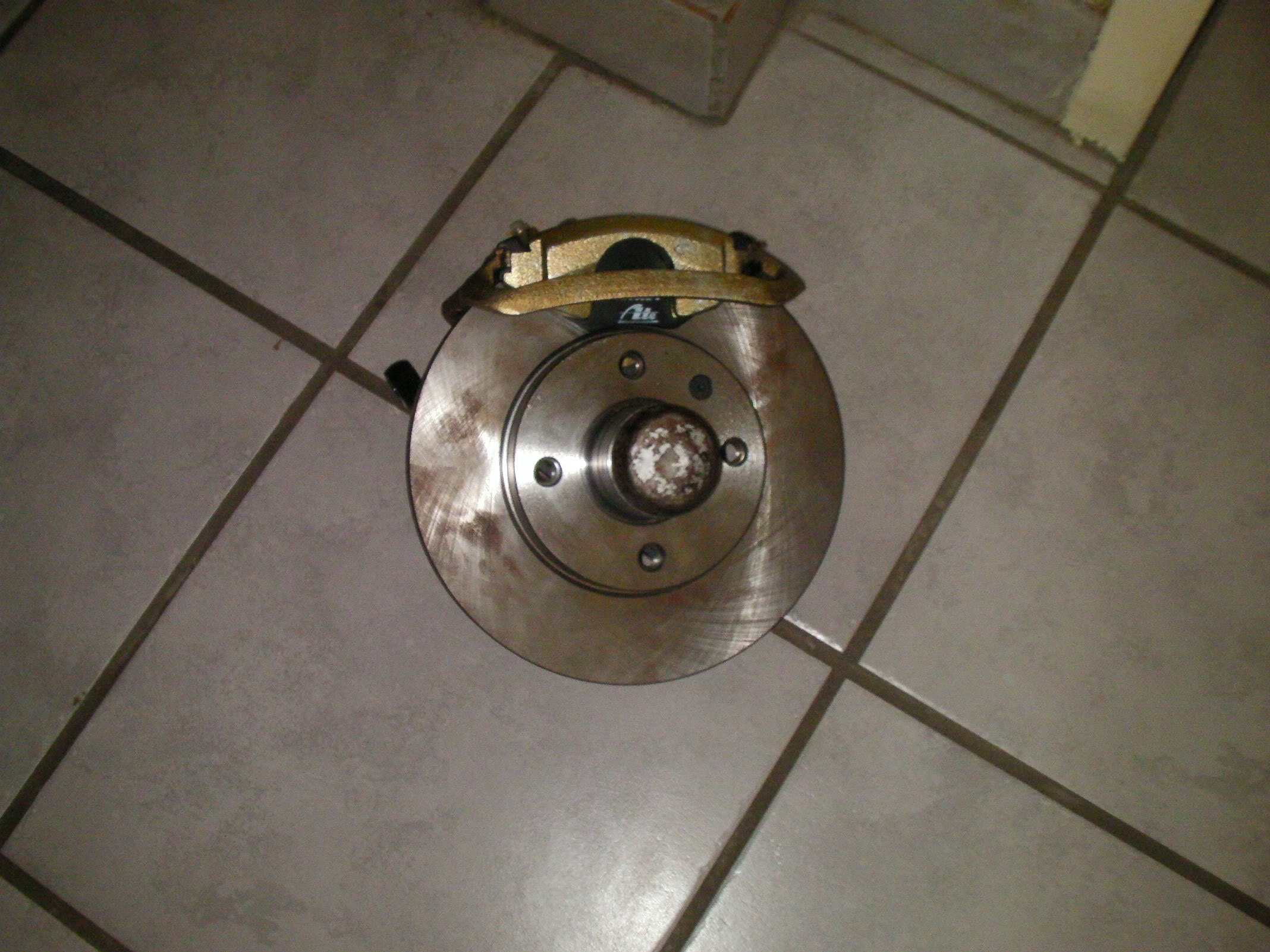

Post by 1972 »
Rui that disk brake kit i got from you is awesome it looks great
is jus a little dirty but is all clean now
here some pics

Rui, that kit looks great,I like the fact that there is no spacer, on my 65 I had the turning circle issues you mentioned.
Just making mental notes for my next bug. Do you know what it would cost to get the calipers anodized red? Or should I just spray it red with some high temp duco ?
