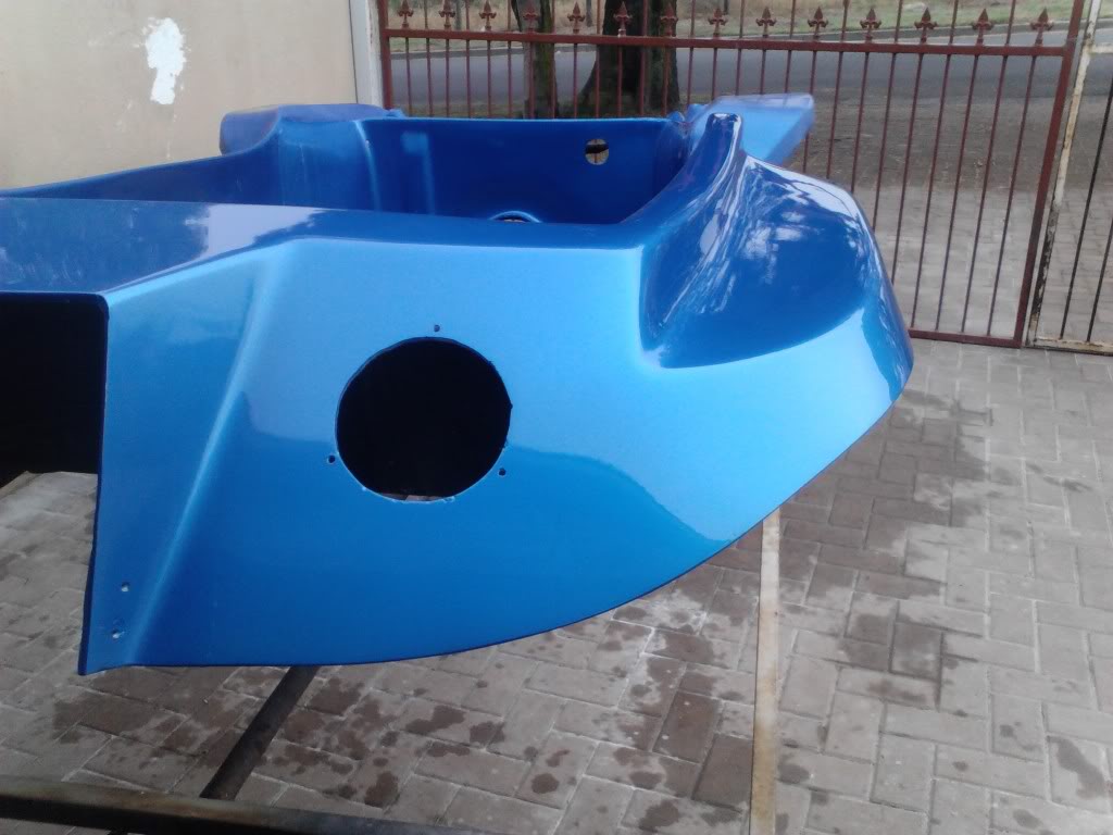

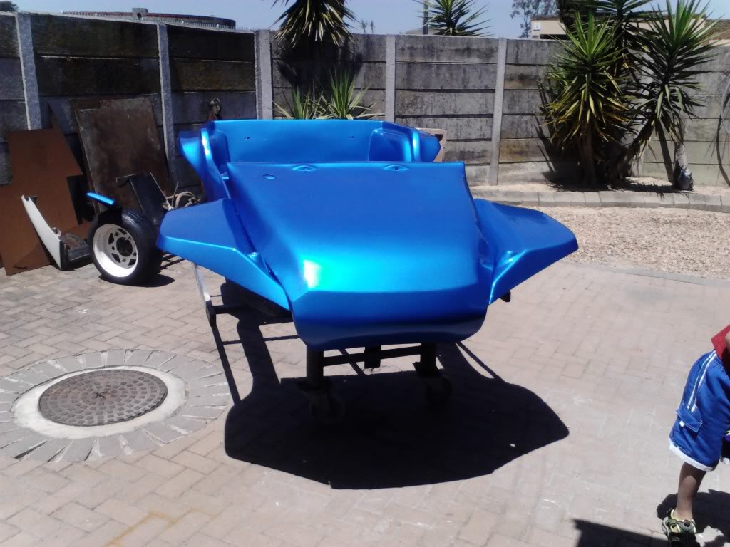

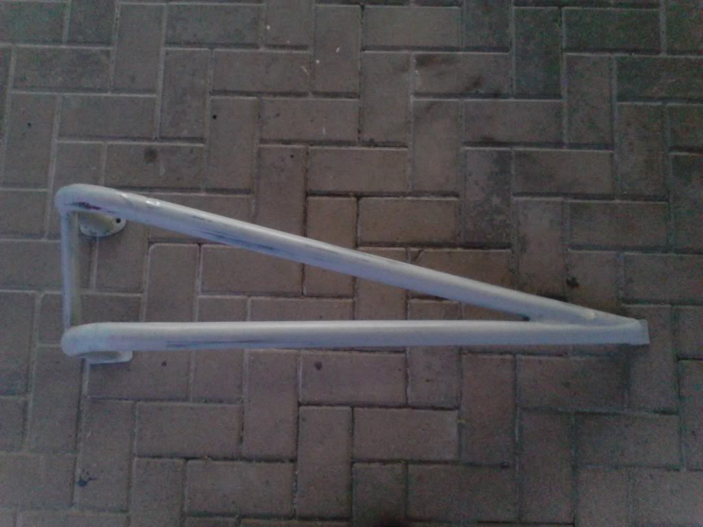

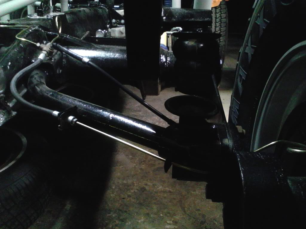

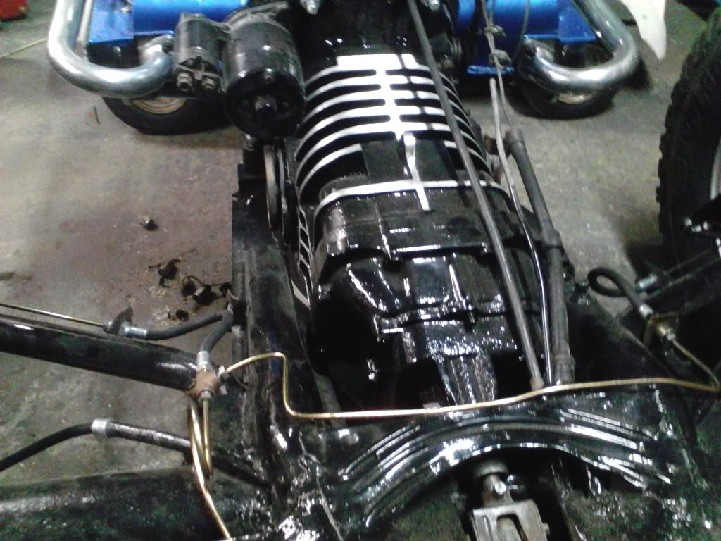

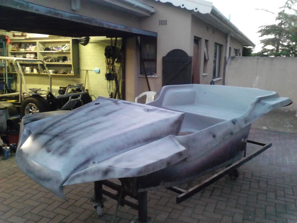

At last i made some progress for a change. Got the body primed, the front bumper finished, made the side bars and roll cage and stripped the rear suspension to lower the torsion bars and do the rear brakes and bearings.

Nice work arno. How many points are you going to secure the roll cage to onto the chassis? Will you be making a flat plate to run between from and rear upright?

Hloni wrote:The "other guys" are correct. I'm sure someone else can give technical reason why they are correct.
The roll cage will be secured at 4 points. The pan had been strengthened with 40x40x3 square tubing wich makes the pan quite ridged and also serve as a body lift.

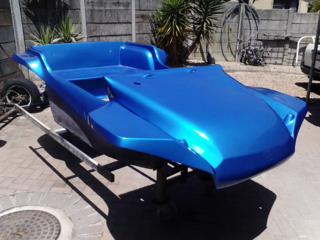

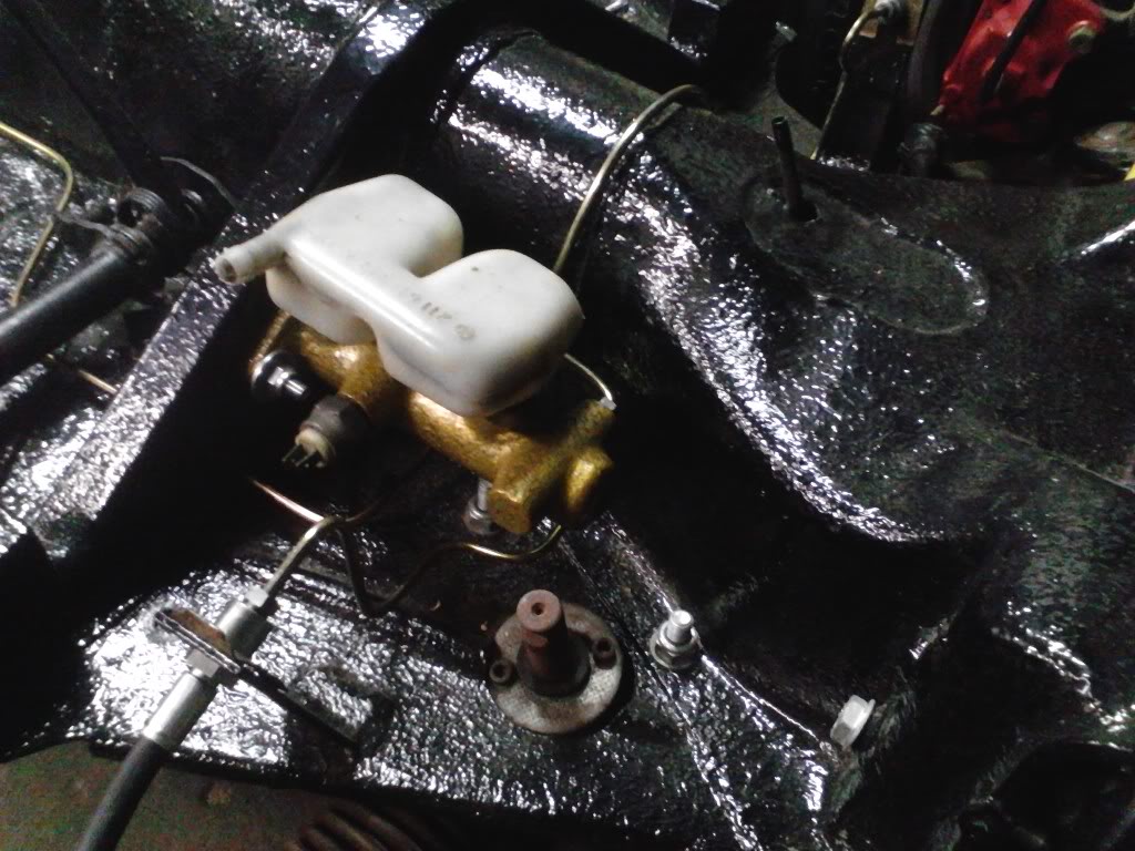

During the last week i overhauled the maste cylinder and the rear wheel cylinders and fitted all new brakelines. I also sprayed and polished the body. Feels like i got something done for a change.
