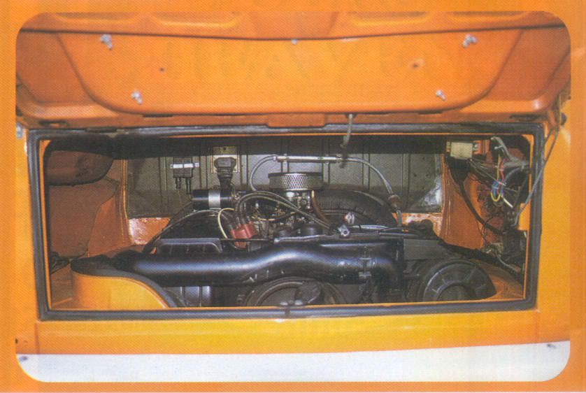

There certainly was a development of the air-cooled VW Type 1 Beetle style engine, which had a full-flow oil-filter mount, which was cast as an integral part, of the left-hand half of the engine crankcase, in a similar fashion, to that of the 1983~92 VW 19/2100 Type 25 (i.e. Vanagon or Transporter T3), water-cooled, spark-ignition (i.e. gasoline-fuelled) flat-four engines. These air-cooled engines (with CT or CZ engine-number prefix), cooled by a crankshaft mounted fan, similar to the VW Type 3 & 4 style, air-cooled engines, were used in the non-North-American specification, 1980~83 VW 1600 Type 25 (i.e. Vanagon or Transporter T3), as discussed at the following Internet links:
http://www.tunacan.net/t4/tech/ct-cz.shtml
http://www.type2.com/library/engineg/boxeng.htm
I also know of one example, where a complete engine assembly of this type, including coverplates and all ancillary components, was substituted into a 1972~79 VW Type 2.
