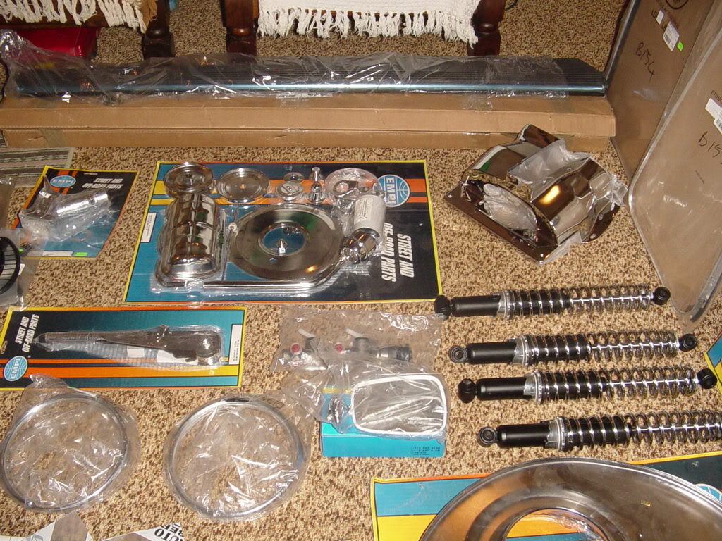

This the ones i have , right in the picture.

Post by Mokwepa »
Those are exactly what i have. They do topout/bottomout on rebound on a rough road but i can live with the odd clunk noise. I might try to squeeze some rubber in there to reduce the clunk. Will my buggy be alright with the wheels now standing at that typical vw angle? (excluding tire wear issues)
