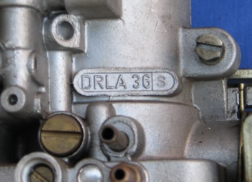

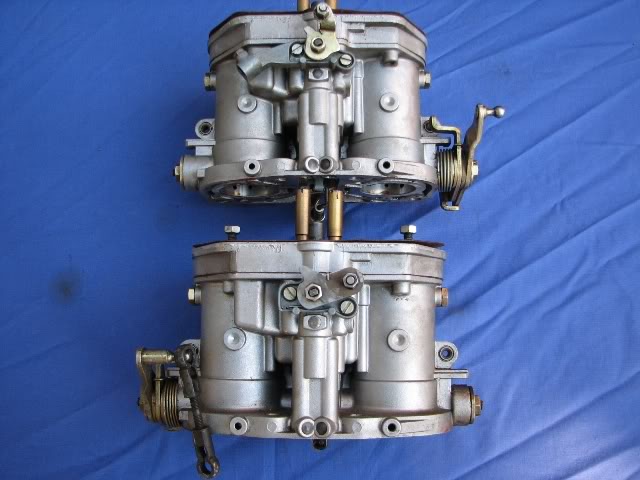

I found this set of Dellorto 36DRLA's at the Modderfontein swop meet. To the best of my knowledge they are the same as IDF's. The manifolds and linkages were another R2K, and I still have to get the filters. Haven't put them on the buggy engine yet..

These are better than the IDFs because these give you a vacuum signal so you don't need to go to the dreaded (by some) 009. It allows you to keep running a vacuum-and-centrifugal advance dizzie which is better than only centrifugal. Especially in a light car like a buggy where any slight hoes-poep-of-skinder is translated into a huge jerk or flat spot.Pine wrote:To the best of my knowledge Dellorto 36DRLA's are the same as IDF's.

Yes, mine also have vacuum connections, same as the four on the barrels of the DLRAs in Pine's pics (these are for balancing the carbs, I was told, they are not really for a vacuum signal for a dizzie, too far from the butterfly valve, he said). But mine do not have the one on the last pic right by the stamp. That's the one you want. I believe there are some IDFs that do have that one, and I know there is a procedure by which one can be machined into an IDF. The engine I took out of the bus has 2 DLRAs and I'm going to use that set up in the Mini-T. The bus now has the 2276cc 2x44 IDFs and 009 dizzie. The weight of the bus negates any flat spot there might have been. Mind you, my buggy runs with a 1914cc 2x 36 IDF's and a 009 and there's no flat spot there either.
