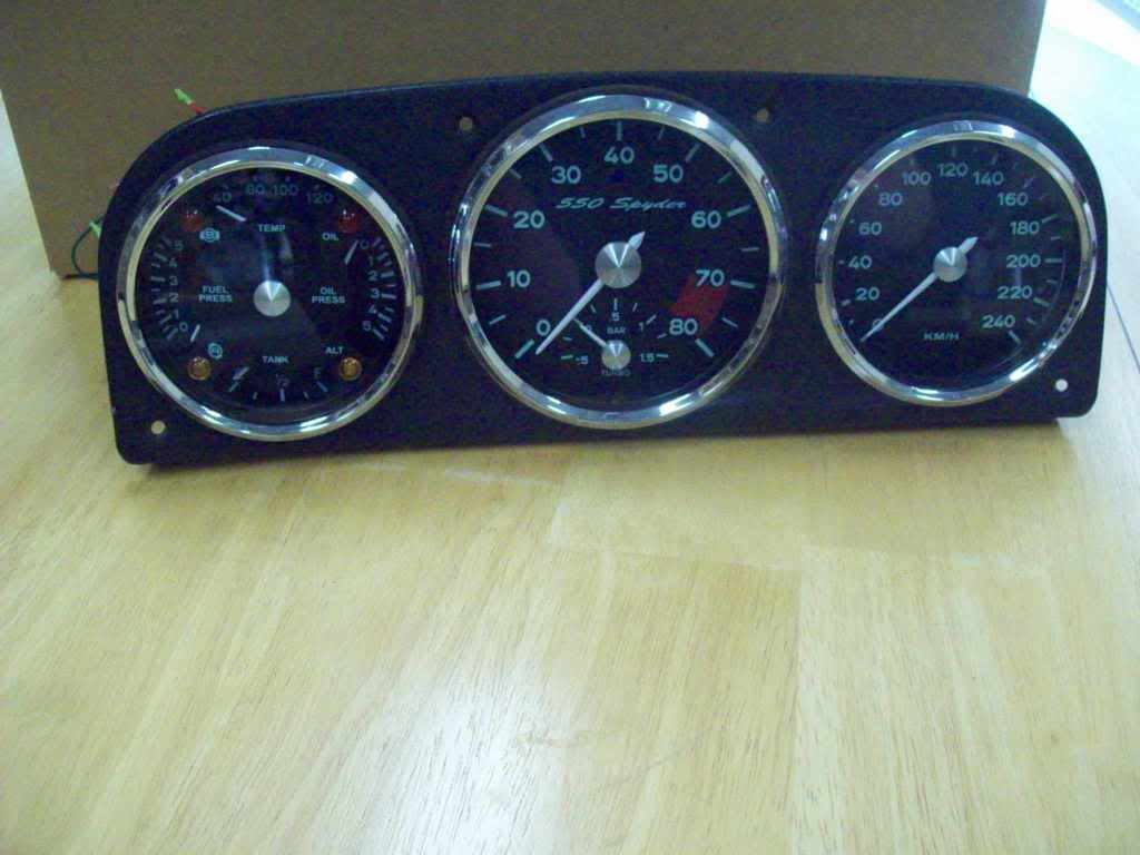

Inside we have had a magnificent set of gauges custom made in the States by NewVintage Gauges. Mark of New Vintage has been fantastic. They have supplied exactly what I wanted. OK there was one area I had to compromise and that is a digital trip. As I wanted to be able to calibrate the speedo myself I had no choice. The clocks are based on the stock 550 type clocks with a rev counter red lining at 7000rpm along with a 1.5bar boost gauge below. The third set of clocks includes the fuel gauge, Oil pressure, Water temperature and for good measure fuel pressure. I could have had volts but a charge light will let me know when the alternator is on the blink. These cost about R10K. But they come complete with all the right sendors, speedo cable, converter in fact even with adaptors to make sure all the sendors work!

Clocks
Picture. . . . Sorry, the board attachment quota has been reached, what can I say

Now how sweet are those !

But did they steal the rest of the car and leave the clocks? I only see one pic

Berry berry Nice!

Sorry guys, that is the only pic I have at the moment, When the body is back from paint I will start putting up pics.
