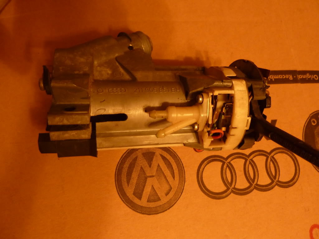

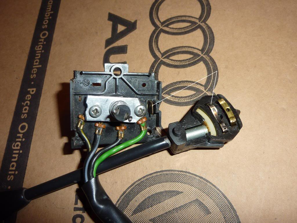

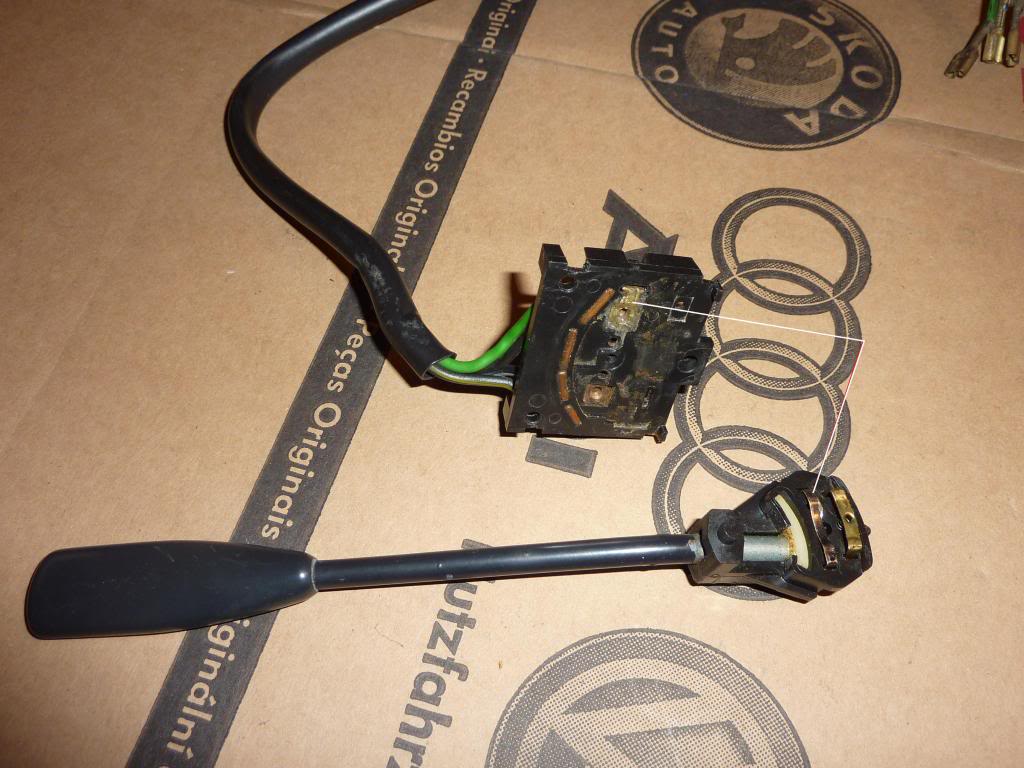

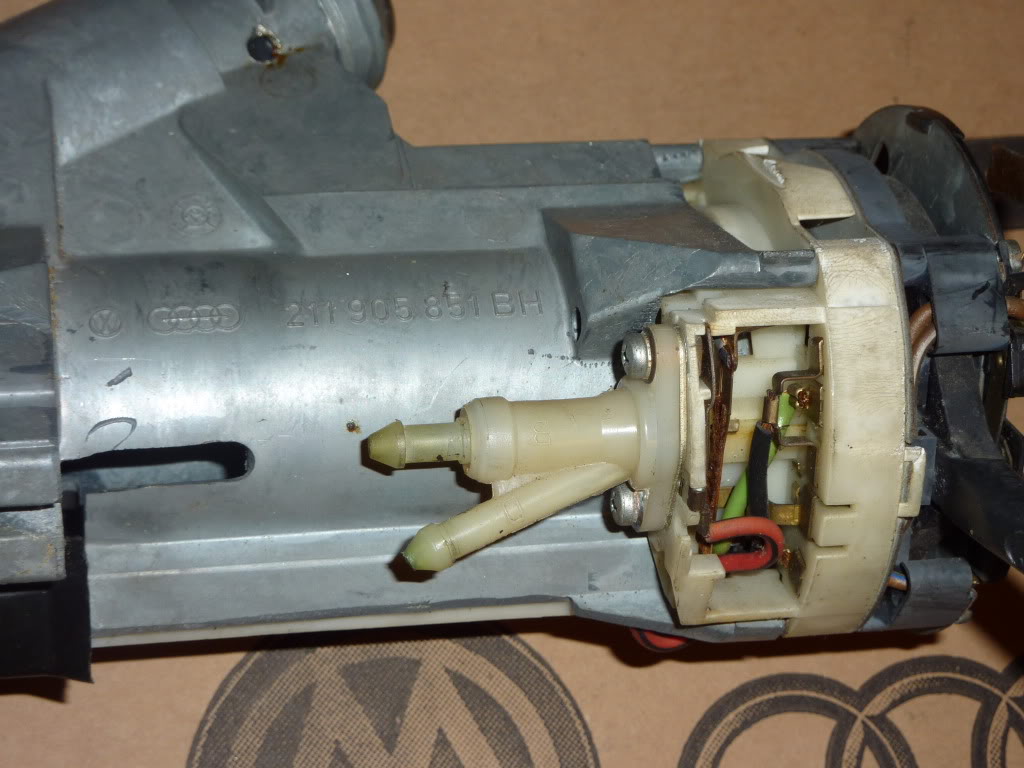

You can have a squiz on ebay, I have a 74 Bay and the stalks are different from around 72/3 to 74.
Later Bays have these:
The 73/74 Bays have these which don't have the electrical connections for a washer pump ....
Trying to make something graft here for the electrical motor ... 'n boer maak 'n plan.
If you want new it's v. hard to find and it'll cast you an arm and a leg.
