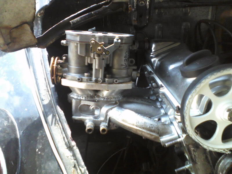

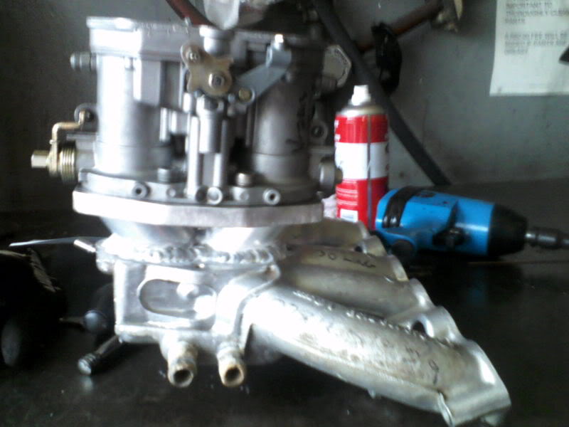

Hi guyz I guess its time for me to join the turbo revolution
As most of you know I have a beetle with a 1.8 8v golf engine

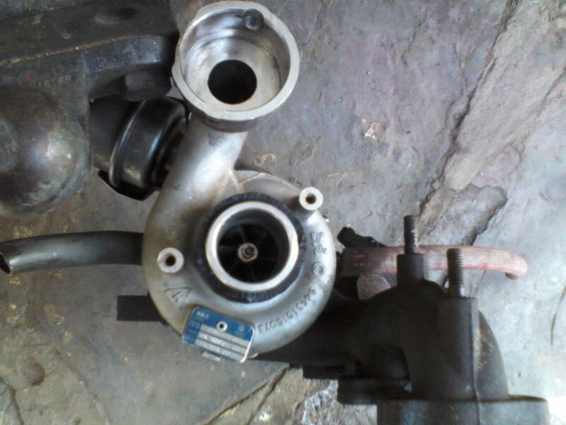

So I decided to turbo charge it so I got hold of a 1.9 Polo TDI turbo I don’t know what size it is but I estimate that it’s a T2?
bolts on to the head no neet for modz

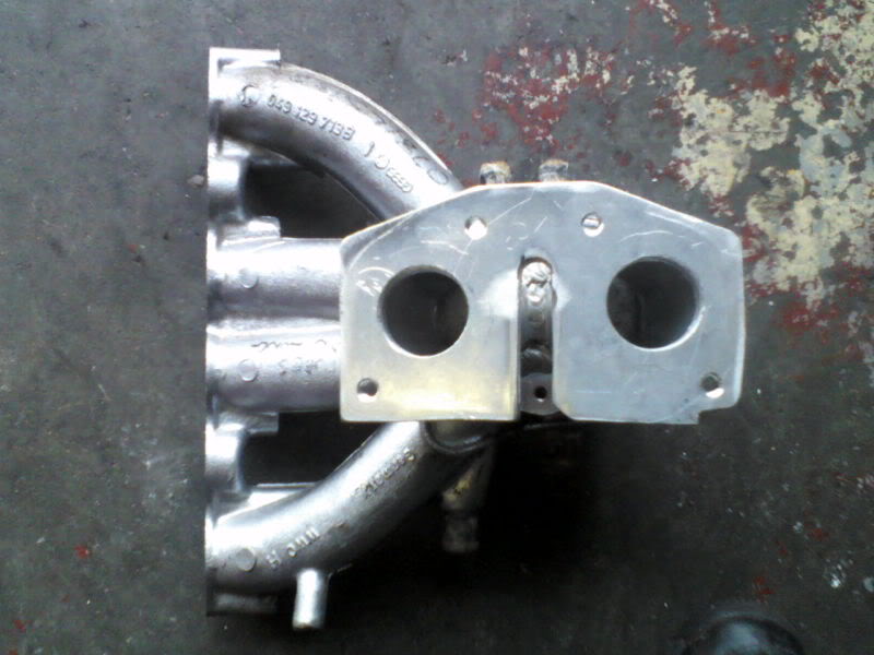

Its gong to be a blow through system , the charge is going to blow into a 36DRLA carburetor that’s turbo prepped

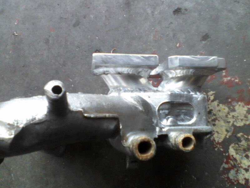

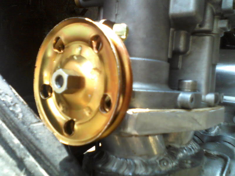

The biggest challenge I had to face was creating an inlet manifold to accommodate the DRLA , so I got 12mil thick aluminum plate and fabricated a flange and some 38 mil tubing to feed the carb into the inlet and got it all welded up.

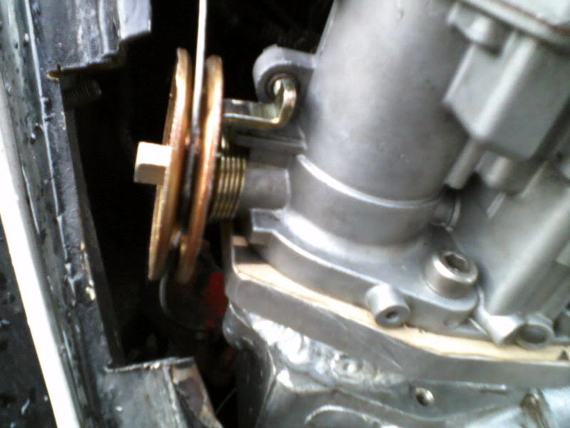

Space is an issue the throttle wheel needed some space so I cut out a little chunk out the bug
Next step fabricate a turbo hat.

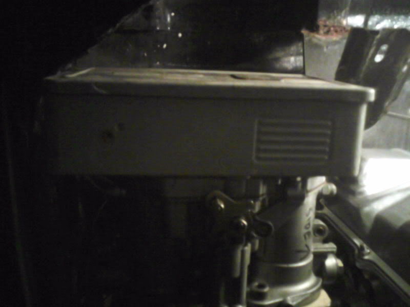

couldint sleep so i went digging in the garage i found a drill bit box thats perfect for my turbo hat i dont think id cut it up its a vintage item so i think il be going to fleet steel tomorrow, the box is a good reference point it has all the dimensions i need for the hat
. Image

fabrication of hat started will make the bottom out of left over ally and the top out of mild steel hope to go to fleet steel tomoro to get some square tubing then the weding starts :hangloose:

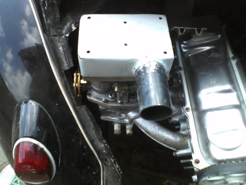

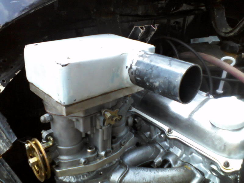

turbo hat under construction
60s look 74 beetle
skype: afronotch

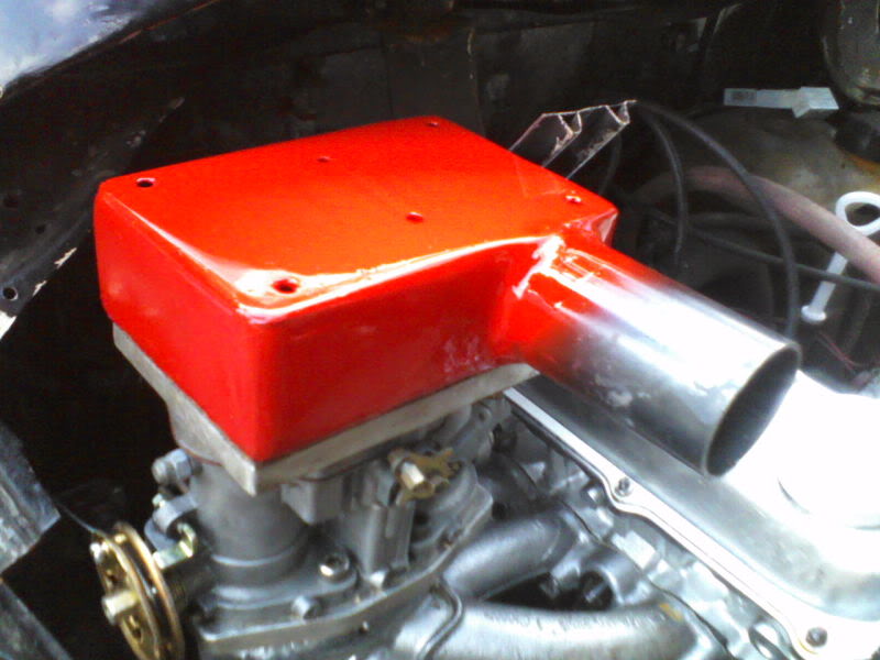

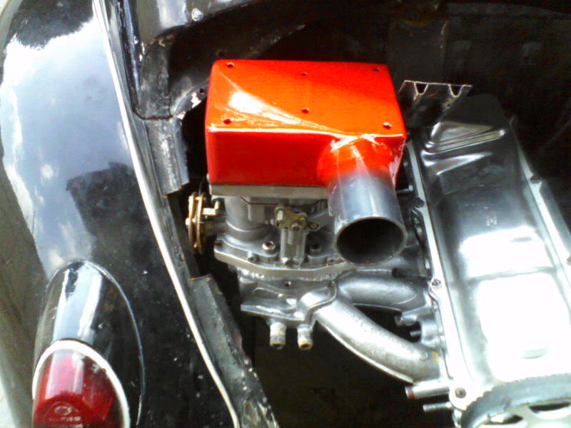

Post by vuyo »

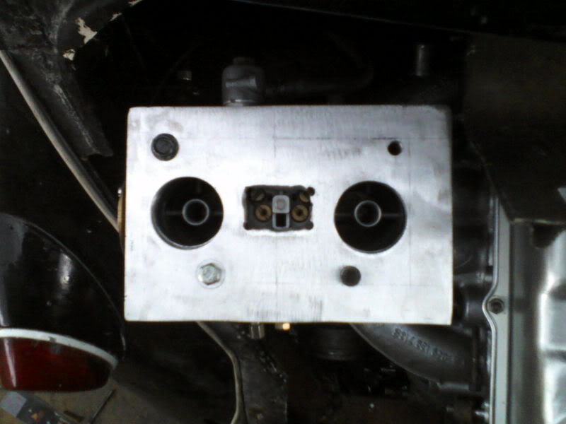

the base plate looks like this it bolts onto the carb
im finsh making the hat i used the bit box
60s look 74 beetle
skype: afronotch

Re: turbo time!!!
Post by JonnoDub »
looking good there Vuyo ! Are you going to rejet that carb to allow for more flow or are you just going to keep your boost low?

Re: turbo time!!!
Post by vuyo »
JonnoDub wrote:looking good there Vuyo ! Are you going to rejet that carb to allow for more flow or are you just going to keep your boost low?
howzit Jonno i dont know about the jeeting yet because i havint run the car with the new carb yet il have to run it under load and see if it needs rejetting if im lucky the jetting in the carb is perfact but i doubt it. im planning on bossting at 0.5 bar.

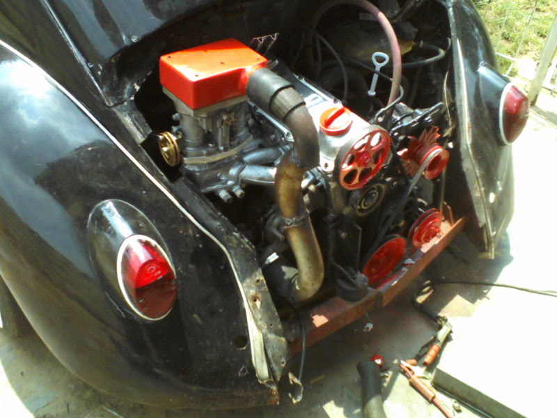

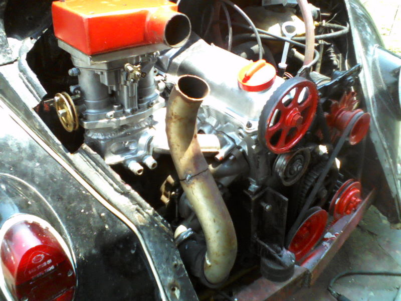

mock up fabrication of the boost pipes. I will go to the pipe benders on saterday
