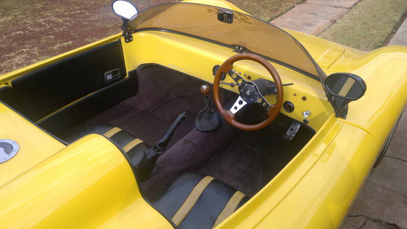

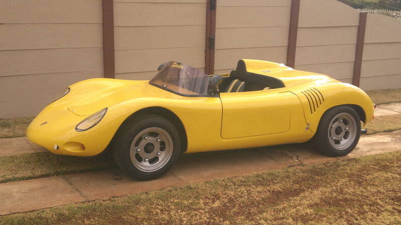

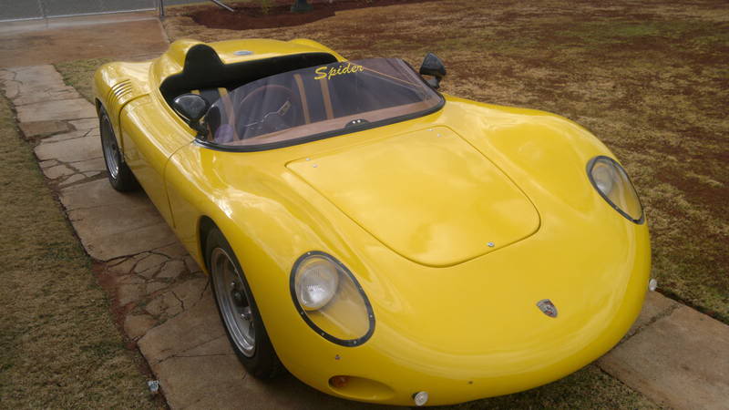

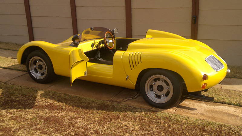

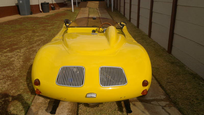

So recently I managed to swop my Landy (old series 3) for a replica RSK 718...

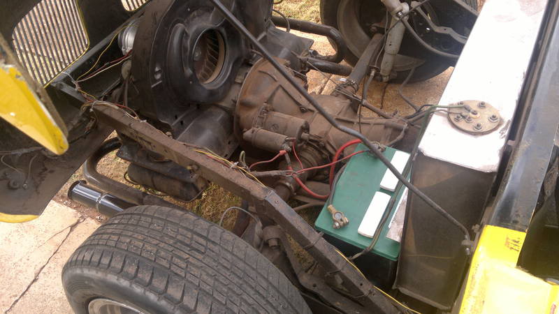

at the side of the road, i noticed a lovely oil puddle, and proceded to check oil.....EMPTY..
now his excuse of " a drop every now and then from the tappet cover" was in fact a worn crank seal...
so after the battle, of getting the car home, and replacing the seal, starting it and letting it idle, showed the same results....OIL everywhere.
So obvious, something with the main bearing spinning in the casing, fly wheel play etc....
