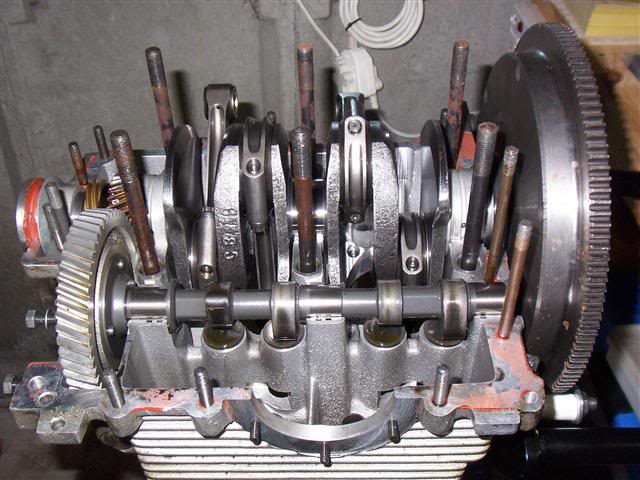

Engine apart
Seems the cam and followers are in nearly perfect condition. All the bearings are also in pretty good condition.

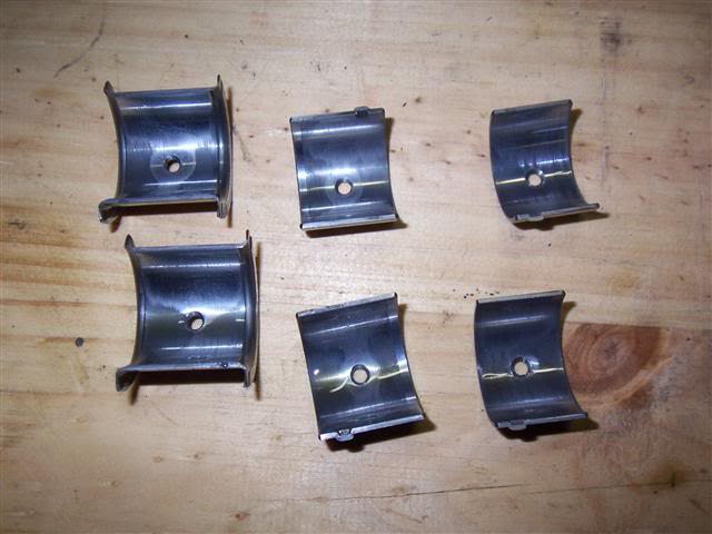

cam bearings
These look in pretty good condition. I probably could have used them again, but decided to upgrade my cam to a 310deg unit for the hell of it, so went with new bearings.

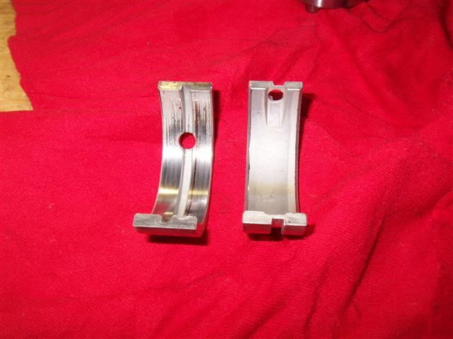

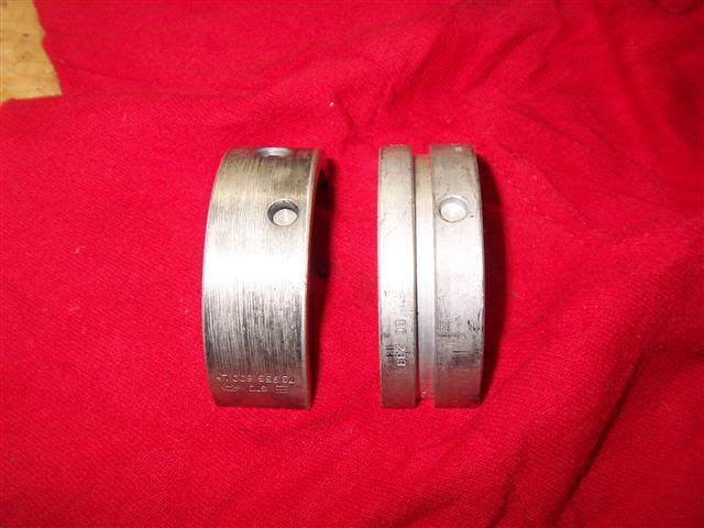

Then on to my new main bearings...
I ordered these as they were advertised as steel backed bearings. Well, not only are they stronger than the aluminium backed bearings, they also have a few changes to them. The oil groove which runs around the bearing is now at the back of the bearing, thus making the bearing surface larger and thereby reducing load (pressure) on the bearing. Also gives the oil a better chance to work. The groove is at the back of the bearing with 2 entry points near the case split.
You can also see the old bearing in comparison (KS).
Then as an added bonus, the #3 bearing which requires removal of the timing pulley to change is now a two piece unit in this bearing kit. So no removing the timing gears next time.... you can see this in the pic of the crank to follow.

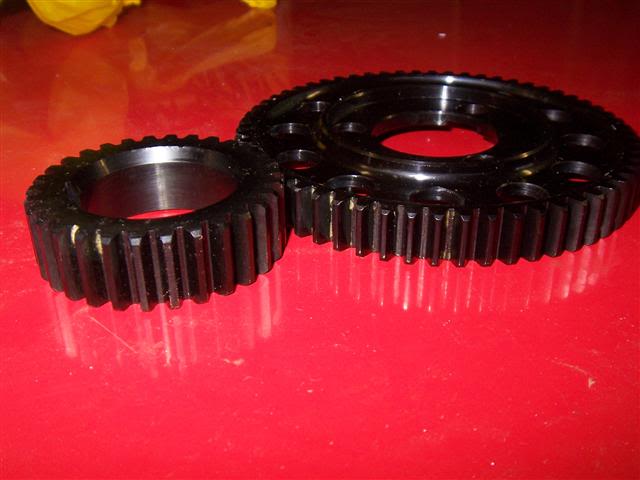

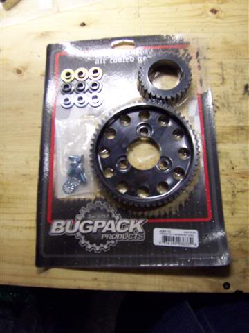

Previously I used a fancy pants timing gear of which only about 180 were made. This was a helical gear with a lower angle than stock, putting the angle between stock and straight cut. This was supposed to reduce side loads (thrust) while keeping the cam quiet. It worked, but the cam gear itself is pitted pretty badly (all the shiney bits maybe?). No option here but to suck it up and go for the straight cut timing gears. This is the one item I didnt want to buy as they are loud. Count your blessings if you have not heard a set.
So yea, no option but to fly in a set.
You can see all the washers.... these are for cam timing adjustments. I installed mine straight up at zero as the cam was ground within 1 degree of the manufacturers spec, and I think he knows best which is why it was designed like that. I can always play around later if I so desire.

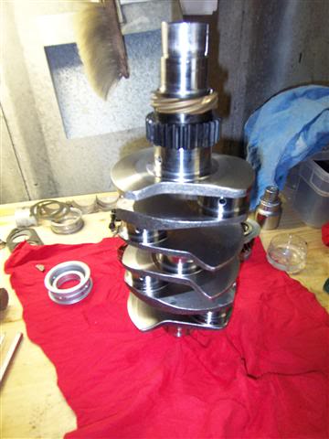

And the crank (without the #3 bearing)

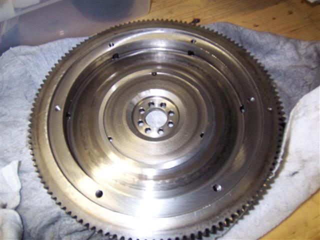

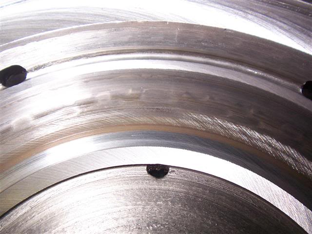

Then onto the flywheel. It appears to have lost the fight against my 4 puck copper clutch and was a bit scarred and warped.
Had it skimmed flat again and then had to have the crank and flywheel re-balanced. It was about 30g out of balance after the skimming.

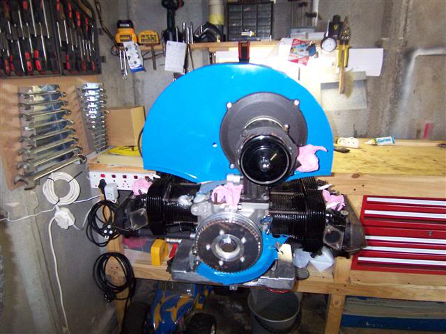

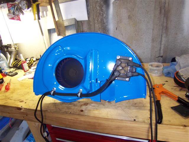

Decided to get my hands on a 36hp style fan housing to free up a little bit of space in the engine bay for the carbs and anything else that needs space. Then modified the fan housing to suit my needs.

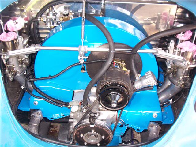

And then the engine came together...
and for the heck of it (bragging rights)

After startup and checking for oil leaks, we went for a test drive. 20km at 120km/h.... all well.
Did have a small issue with my linkage which needs tweaking, but otherwise all went well.
The 310 deg cam definitely comes alive around 4000rpm, but with the engine being a 2332, it isnt difficult to drive at lower rpm. To be honest, it feels fine even when putting your foot down at lower rpm, but you definitely notice everything starting to work together properly at 4000rpm.
